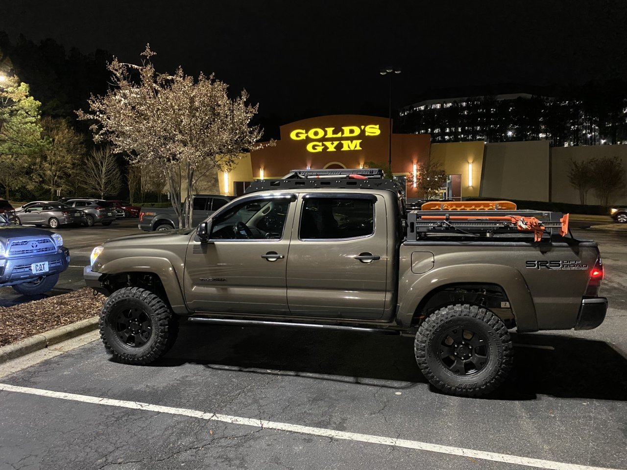

    Took the Tent of and boy is it more zippi lol

    Looks great!:drool:
    please do keep us posted on how your mpgs are affected
