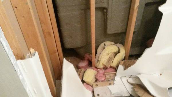

    Cutting the edge in the drywall around the tub was mildly therapeutic. Didn't even really care that I had to do it with hand tools, heh...
    Got a nice view of the back of the other tub. Some random peices of insulation were laying back there.
    I noticed there is a very slight leak from the other shower where the grab handle was installed. Now might be a good time to take care of that...

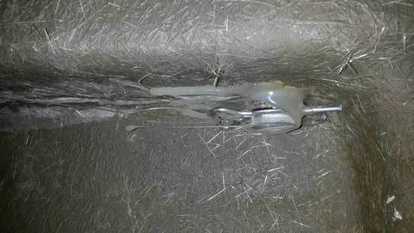

    Well, I guess you could say I've been cutting into it a little bit more...
    A friend of mine who is retired and does this kind of stuff for "fun" these days, came over and checked out my work and made sure I was heading the right direction. He informed me that there should have been a stud on this wall about where the linoleum starts. The tub was screwed into insulation, so it wasn't very secure. I think along with fixing the minor leak on the other tub while I have it open, I am going to address this issue as well. Do I have to put a stud in there all the way from floor to ceiling?
    So long, farewell, good riddance...

    Put in a stud on the flat , floor to ceiling at the location of where the shower stall / drywall transition is , nail a stud on edge to it for strength , essentially making an " L "

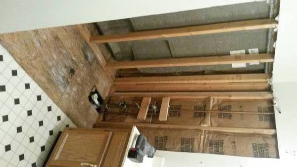

    My first attempt at removing the vanity was halted when I tried to turn the hot water off and the valve wouldn't close all the way. Now that I've messed with it, it drips. Is replacing one of these things as straightforward as it looks?

    Copper pipe, compression fitting.... you'll need to loosen the rear nut while holding the valve. If you're lucky, you can slip the collar off of the pipe. If not, you'll need to cut the pipe right behind the collar to allow a new one to slip on... the new valve will be 1/2" or so closer to the wall.
    A few jobs like this and you learn that it is a very good idea to cycle every water valve on the property a couple of times a year... including the gate valve at the service entrance.
    My gate valve needs to be replaced, it does not fully close. Any time I need to work on a fixture that doesn't have its own shutoff (like the shower, or to change a valve), I have to open the hose bib outside to allow what leaks past the gate valve to drain.
