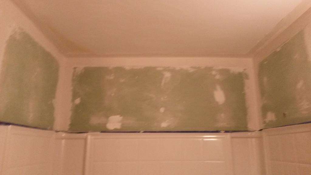

    Okay I lied. I figured out how to do it from my phone.
    Where as it looks like a gap, that's painter's tape masking off the edge of the tub. It needs another layer and then some sanding and hopefully it's ready for prime and paint.

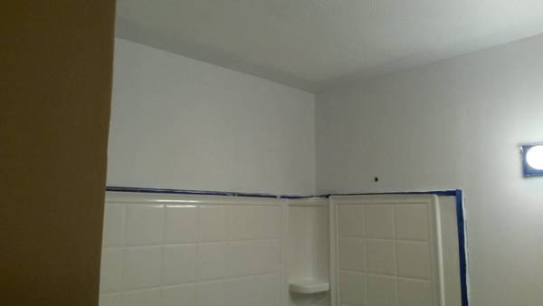

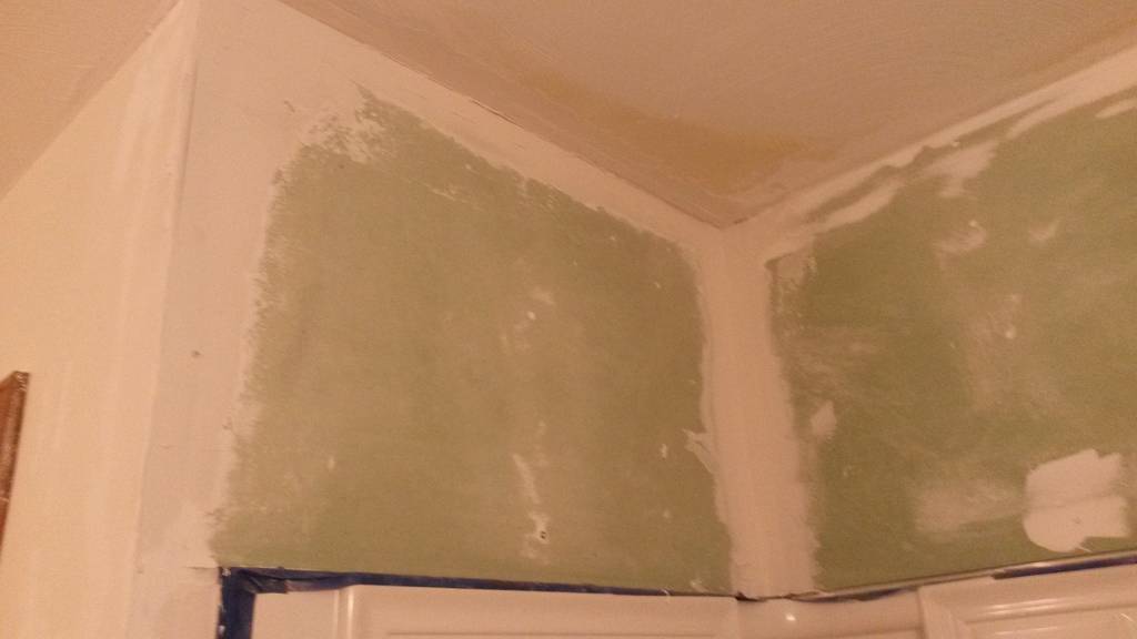

    <bump>
    I'm still working on the drywall but I'm almost ready to paint. I'm cleaning and patching some dings mostly. I've noticed that a few of them are things that were from original construction, so I hope that is a good sign lol....

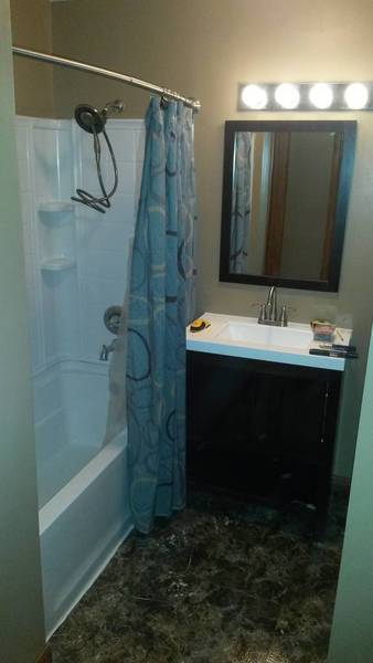

    I guess I will go ahead and finish off with a final update. Things have been busy and progress has been slow, but I forged onward...
    I got two good coats of primer on the wall. Funny how you think you get good coverage the first coat and then it dries...

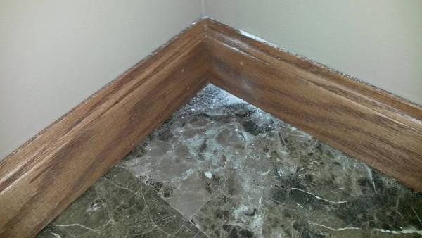

    New floor went in. Linoleum, but nice linoleum...
    New trim. I applied the knowledge (and the leftovers) learned from Oz-T during last year's laminate flooring project regarding coping an inside corner.
    My dad explained the simple yet valuable skill of using masking tape when laying a caulk bead where the vanity meets the wall.
    I felt a draft coming in from between the tub surround and the tub itself. I didn't want to take any chances so I sealed it with silicone. The tape may have not been needed, but given my skills with a caulk gun around the tub and the wall, I used it.

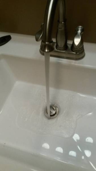

    Getting this hooked up and working without leaks had me filled with the sin of pride. (I also replaced a shut off valve on my toilet all by myself, including turning the water off at the main this time)
    And here we are. Previous toilet cleaned an reused, trim was leftovers from laminate project, existing light fixtures were cleaned and reused (although now off-center a wee bit) Tub and surround are new, tub fixtures were a gift, professional only called twice so I did most of the work myself, and more importantly everything works. So what started as hairline cracks and a leaky tub, ended in a whole bathroom remodel for about the same price as ReBath wanted to charge me for tub replacement. Now...time to take a shower...

    Just when I think I'm done my p-trap is dripping...I guess that's an easy fix comparatively...
