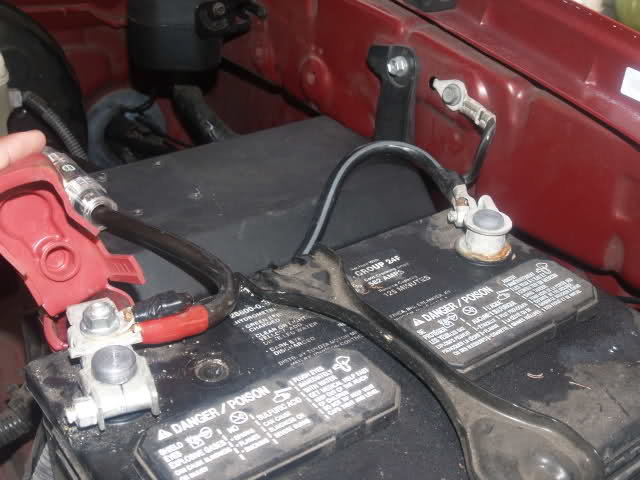

    I want to keep my terminals clean though. Not happy with the way it is right now either, although I thought that I would only need to worry about a power wire. Now I have to upgrade just to have the system work properly. :(

    this is how it is right now, excluding the plastic cover on the positive, it's covering like it should.

    Or you could do what I did, get a battery (if you need it that is, which I did) that has two sets of terminals. Use one set for the factory connections, and use the other set of terminals for the stereo and the big 3.

    I LIKE!!! how much was that battery?
