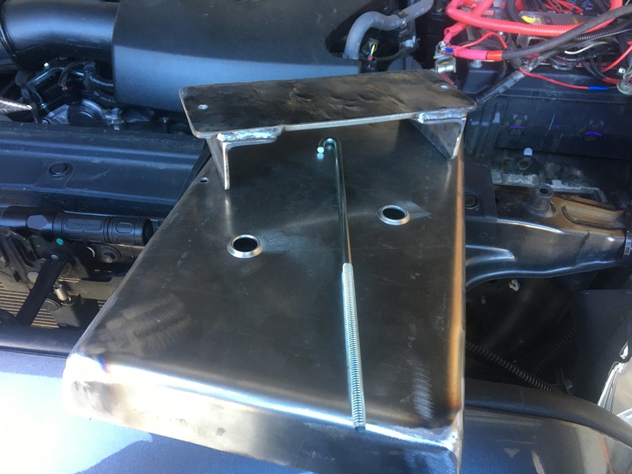

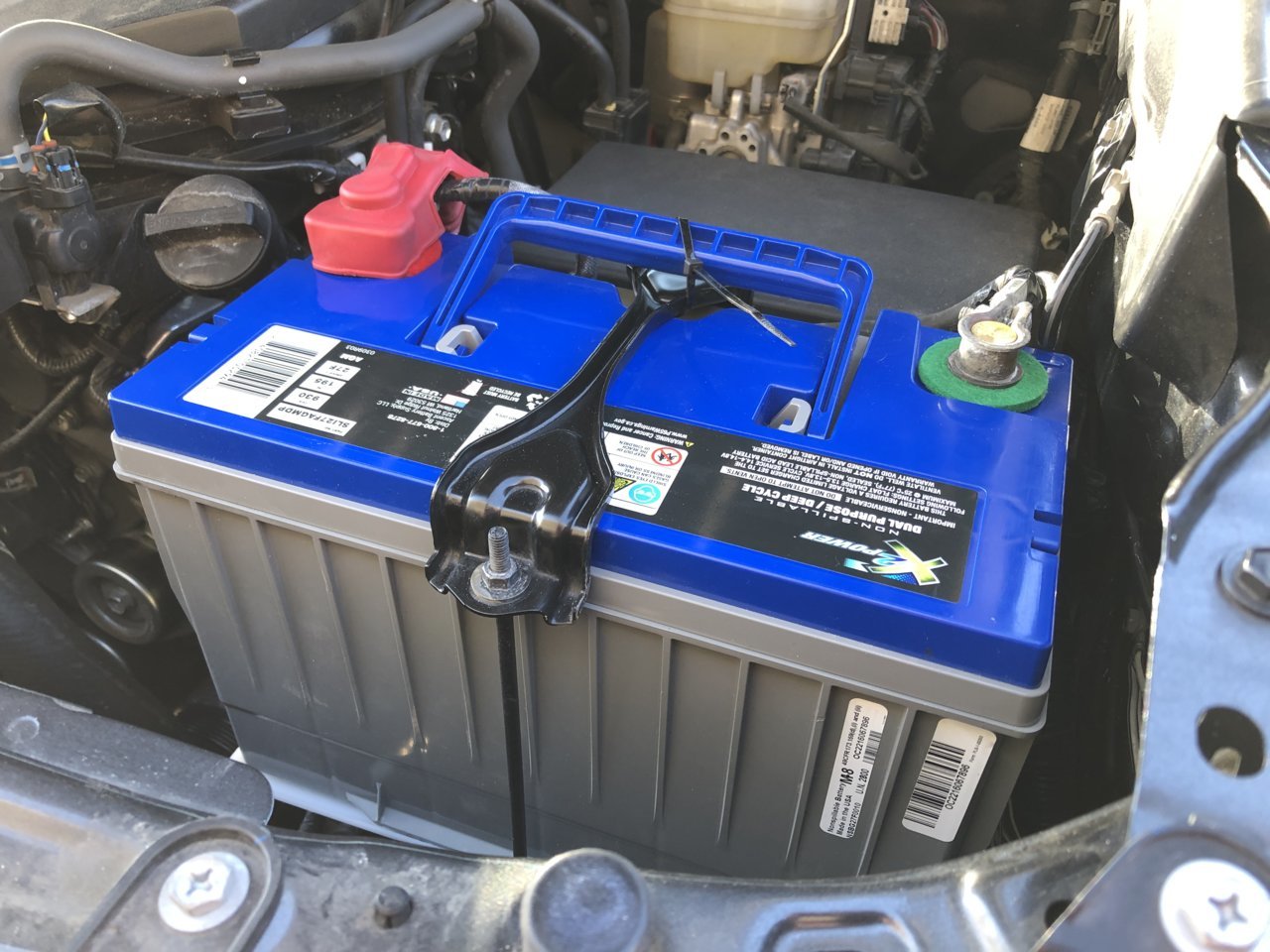

    Fabricated up a tray out of 13 gauge steel and made a new hold down. 1/2 inch dimple dies fit perfectly into the factory tray location holes.
    I also put battery on charger over night and after 3 hours of rest it’s sitting at 13.2 volts! :thumbsup:

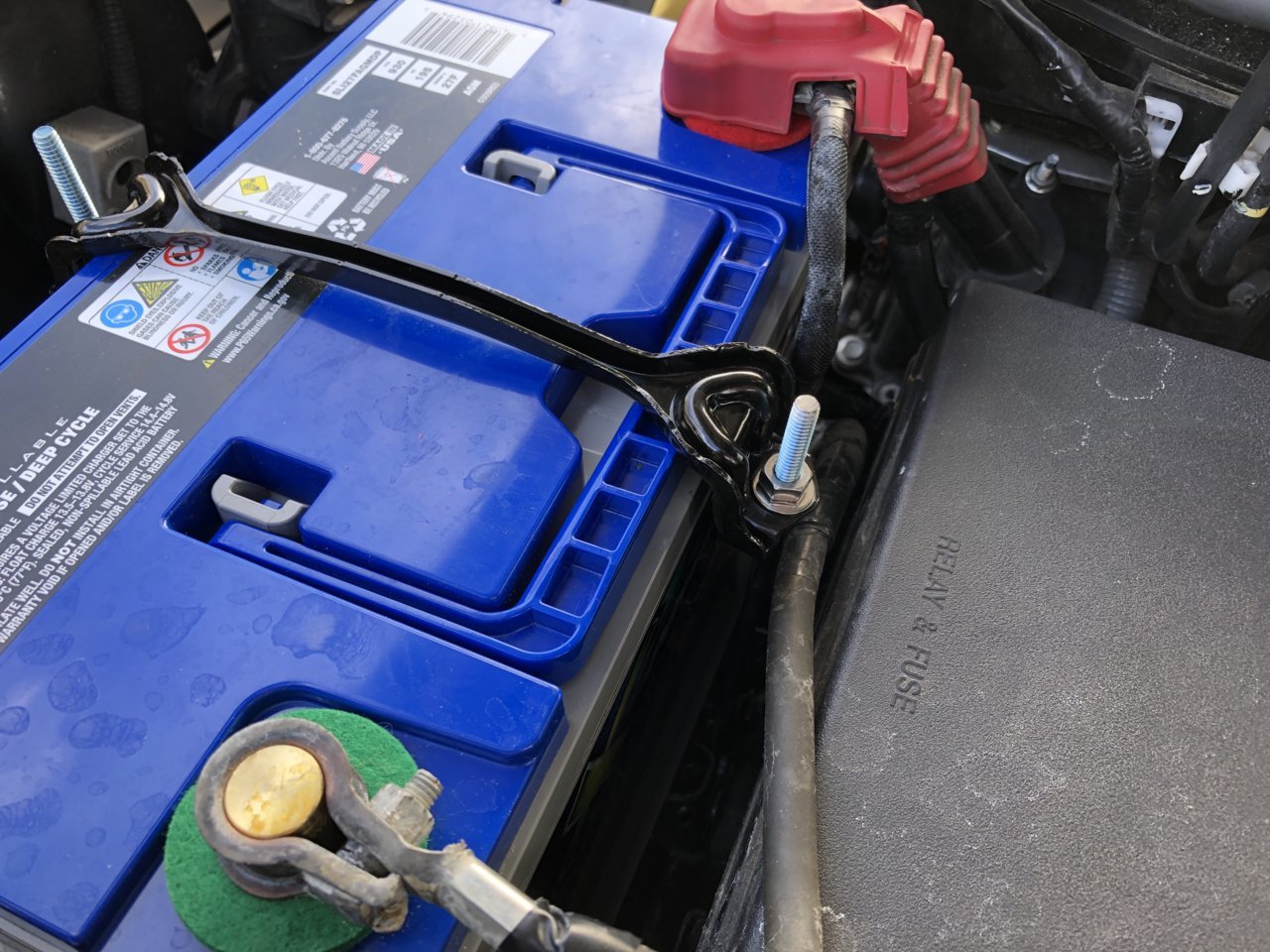

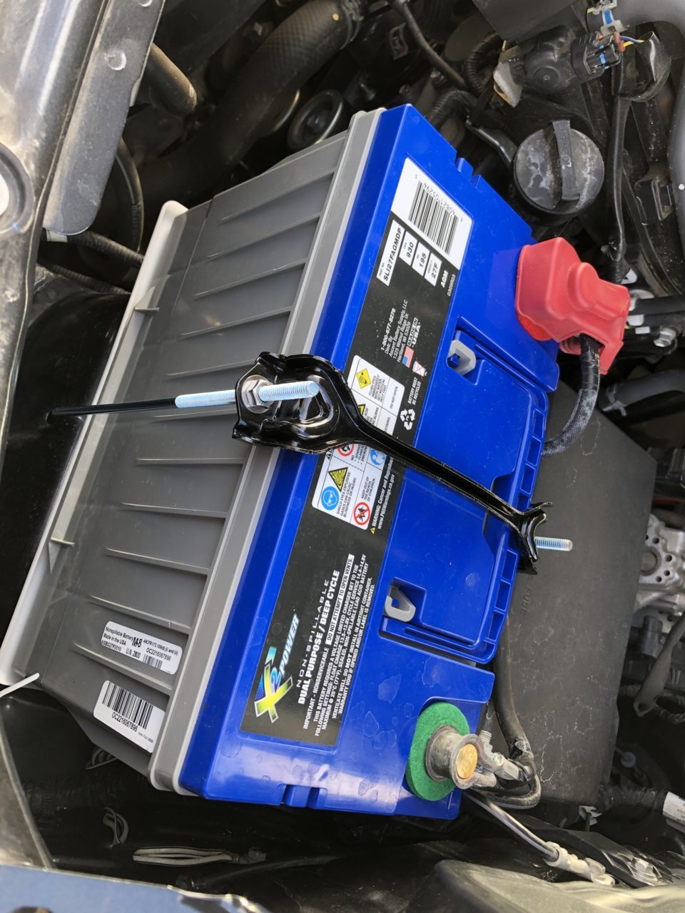

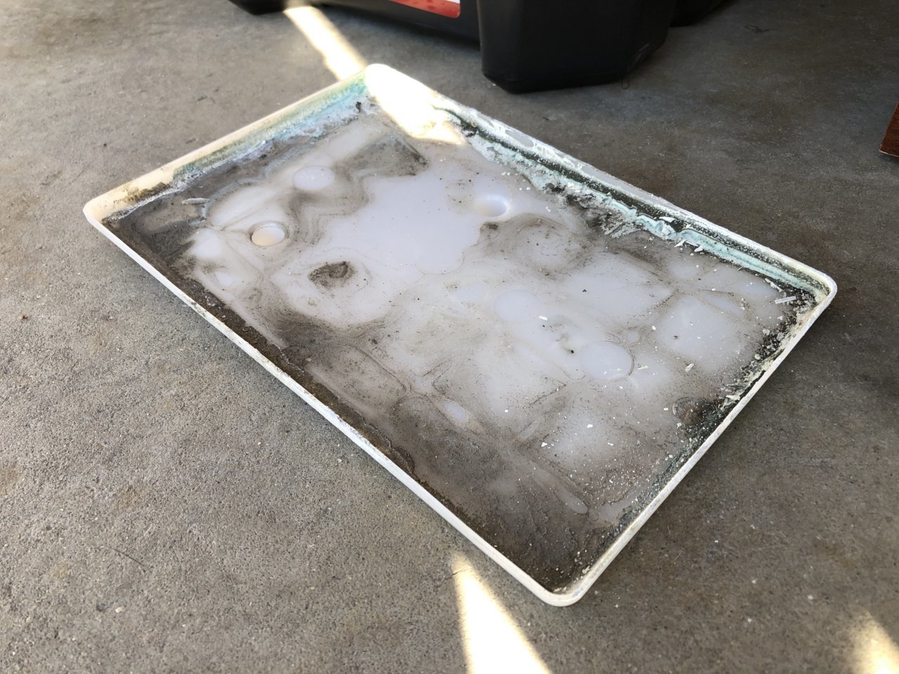

    Took advantage of this deal and went with the 27F Group battery. After rebate it costs $282. The only thing I had to do is run the battery clamp underneath the battery carrying handle since it wouldn’t fit with the handle down. I zipped tied the handle to the clamp to prevent any rattle. Here’s a pic of the old battery tray and new battery installed:
    FE7072FF-A18B-4180-A370-0459DE2CCA99.jpg A4009ED3-D0EE-49B0-A136-30179AB3A4F2.jpg
