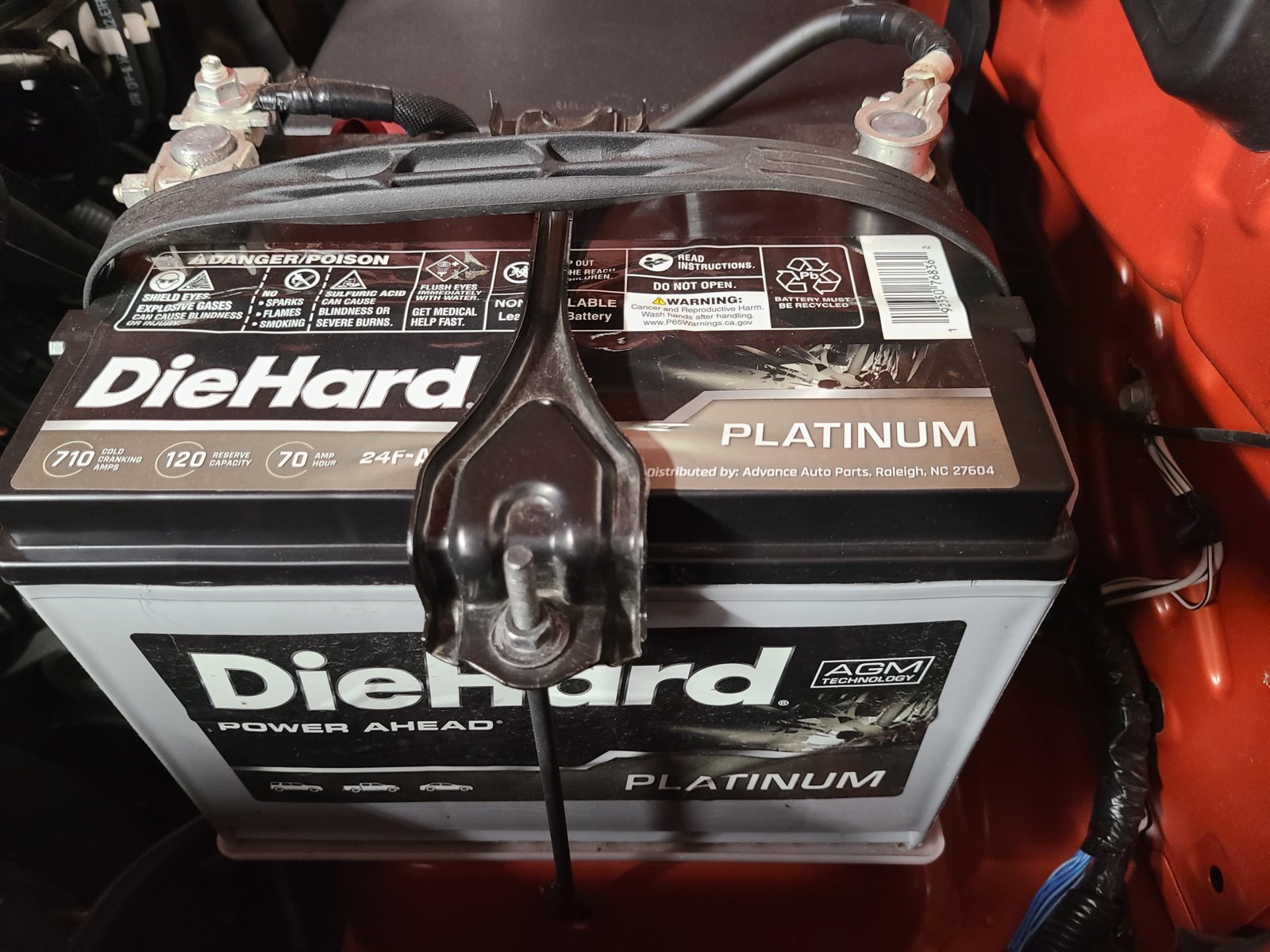

    Been running this inexpensive, probably mediocre at best AGM in my untuned Tacoma since April '18, and it hasn't "needed" a thing.
    Oh, and look, no corrosion, anywhere..
