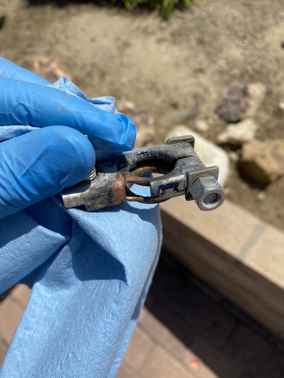

    Remove the terminals if necessary to insure everything is good and clean, then bolt them back on and give them a spritz.
    Follow up with a visual inspection and spritz every oil change. Usually they stay corrosion free.

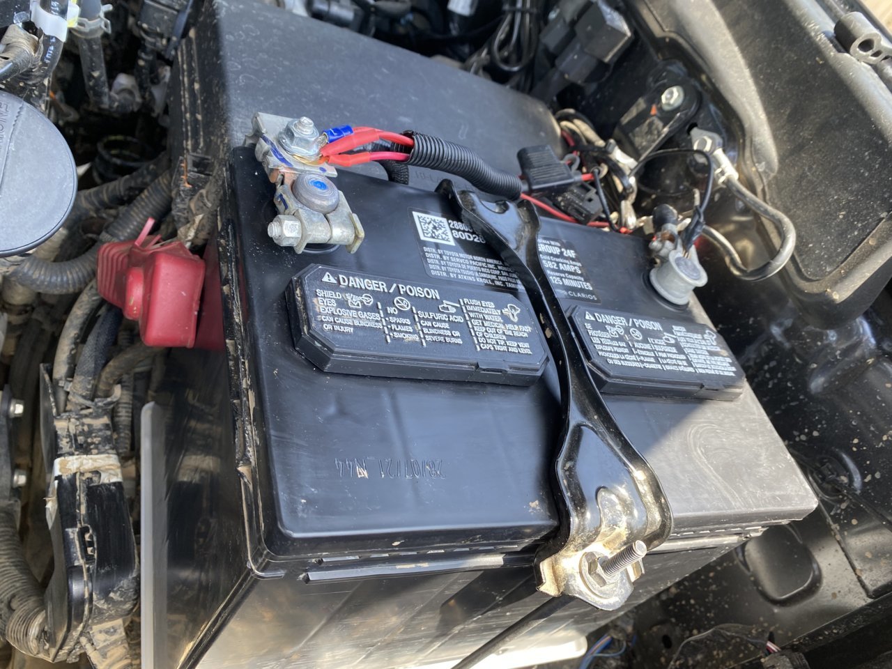

    Seems much better
    also is the terminal corroded or is it okay?

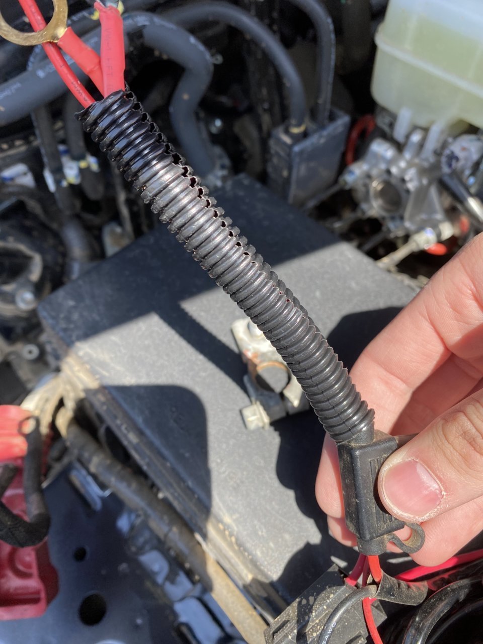

    @RustyGreen I had some extra wire loom so it worked out well

    That is looking better. :thumbsup: Good job!

    If it continues to be a problem upgrade to a better battery. I have the yellowtop and love it. Also a little dielectric grease might not be a bad idea.

    Remove terminals, Clean both sides, Use the battery terminal wire brush, Add Dielectric grease and reassemble.
