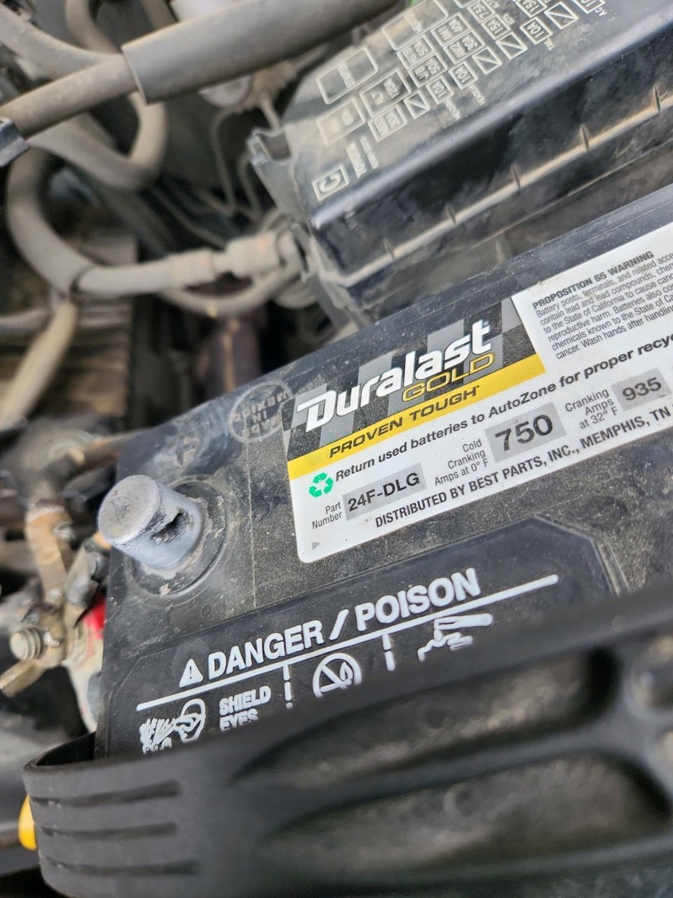

    Pictures of your battery and the bracket that got arced?

    After reading a lot of stuff and a few tests I think the problem might lie in the ecu is toast. Tried starting it with a shot of starter fluid and no start or attempted start so im not getting spark.
    As requested this is what the post looks like.

    With the damage to the battery I hope you replaced the cable I can see that being a big part.
