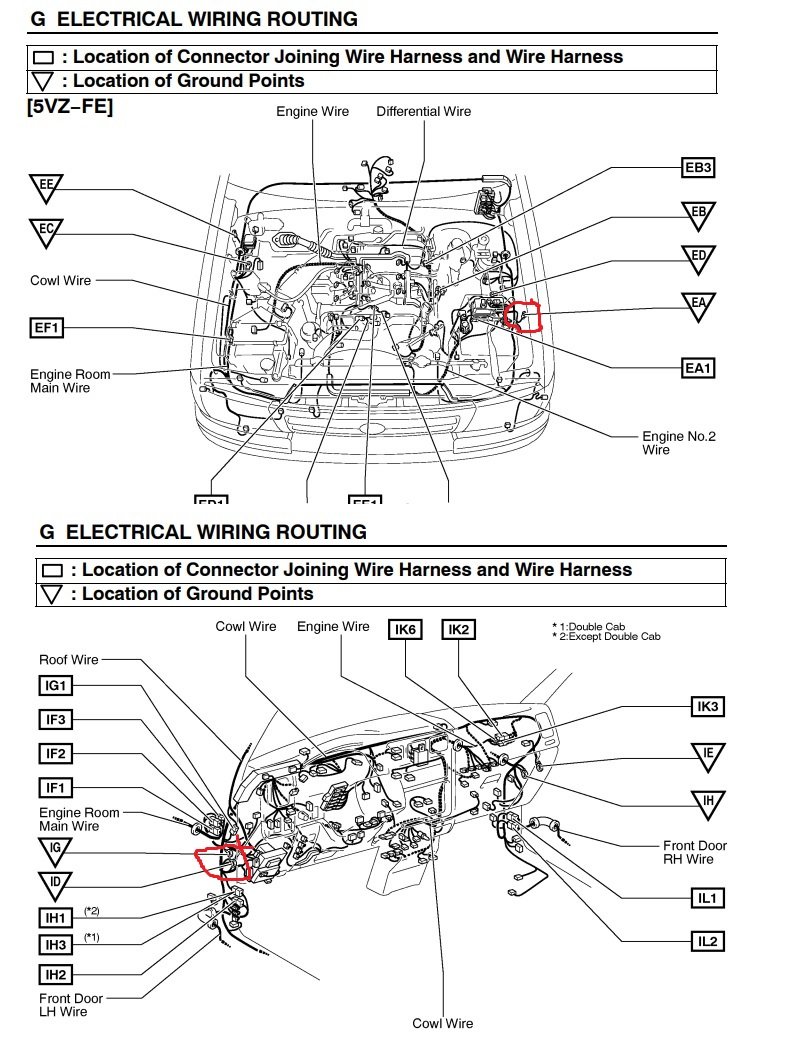

    What do the ground wires at EA and IG look like?

    Far as i know the ground wire that looks cut has been that way since ive owned this truck. I will look into fixing that soon but since it wasn't active turning incident its "good"

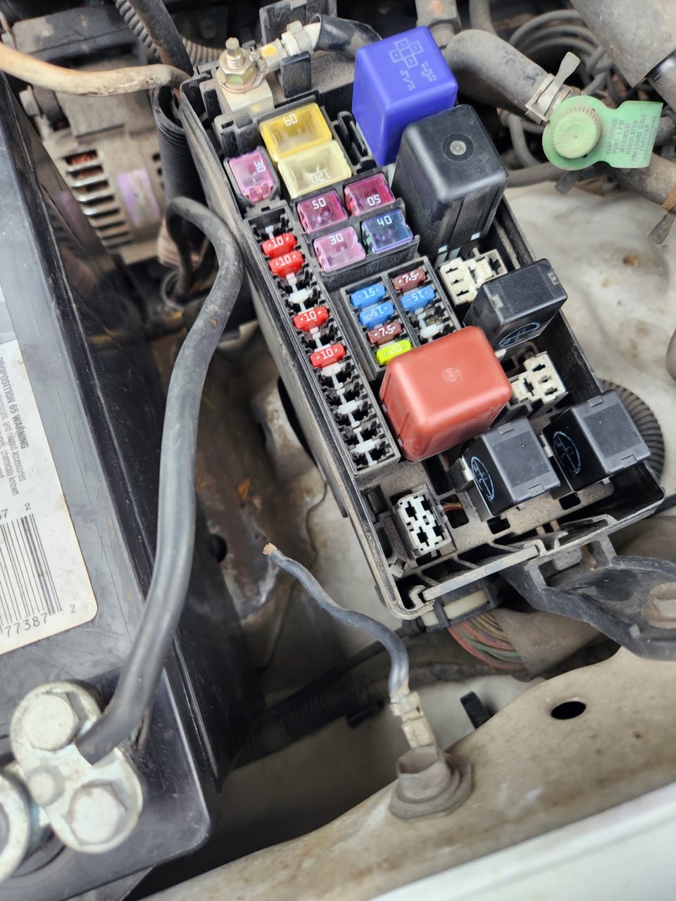

    There are 2 ground wires that ground the chassis to the battery, one that comes off of the inner fender by the battery that is not connected and one that comes off the firewall to the cylinder head. Connect the fender wire and get back to us.

    That cut wire should be the main body ground to the battery, that means the current had to have found an alternate path probably though another much smaller ground wire.
    I'd want to look at all the wires going to all the ground points on the body for any that are burned or melted.

    It looks like he fried the neg term to body ground wire...
    straps are way over rated anyways....
    That means his only ground is off the engine mount....
    So that one little wire WAS grounding ecm, body electronics, injectors, coil packs, light bulbs, and all the engine sensors at the same time...........wow...that was a busy little wire.....bless its heart....
