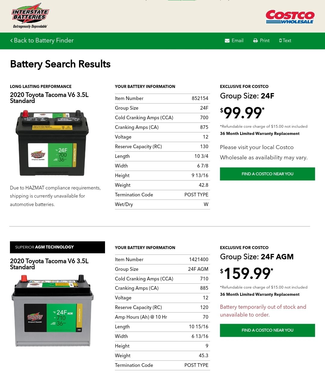

    Leer 100XR
    Costco
    frenchee, tacotoe, leid and 1 other person like this.

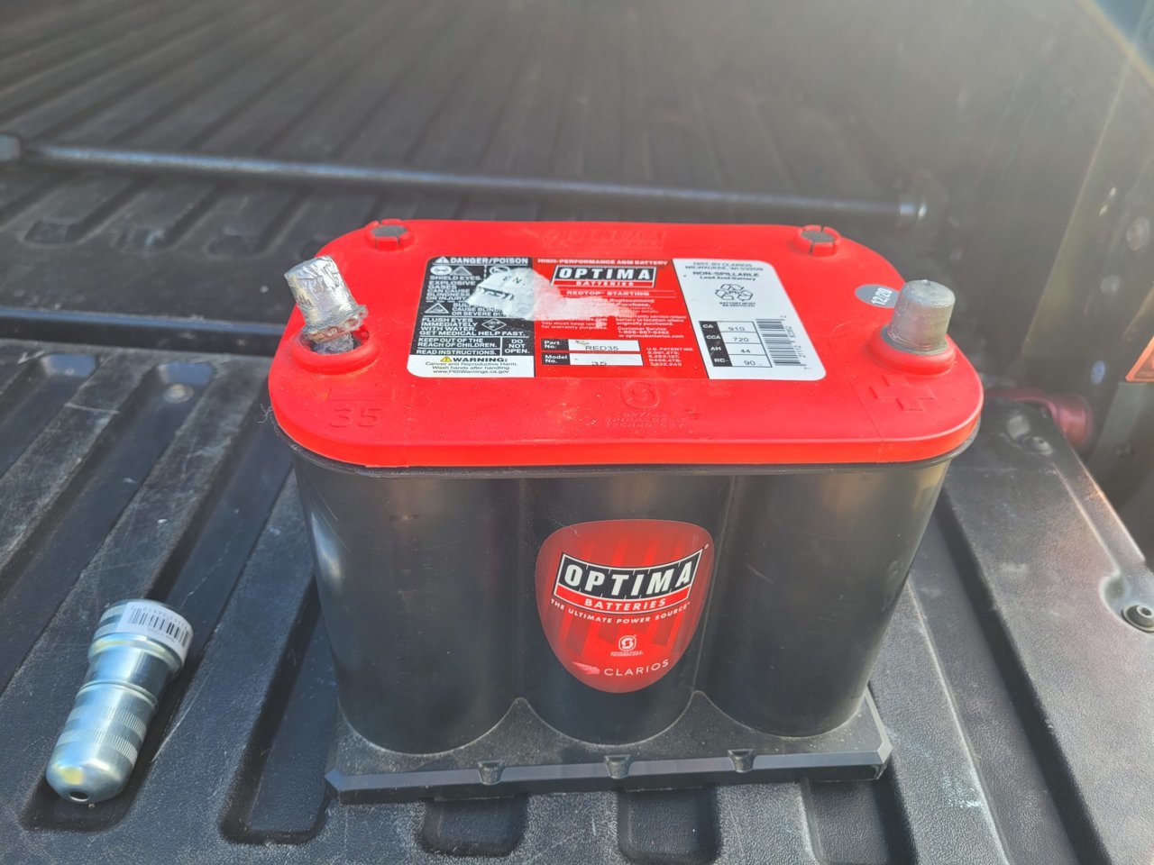

    gtrotter07
    gtrotter07 Well-Known Member
    Jul 19, 2019
    #299768
    404
    2007 Tacoma reg cab 4x4 on 37's; 2021 TRD Offroad, 6 speed
    37's,lockers, bumpers, bobbed etc.
    I would avoid Optima. Bought one this spring, and lately was having issues with random dimming etc. Decided to check terminals, and clean. Went to remove the neg. terminal and it just twisted off. I was only using a 1/4 ratchet, so minimal torque from me. I suspect corrosion? Either way, this will be my last Optima.
    Edit...the gouge marks on the terminal are from me trying to reset the terminal back in place.
