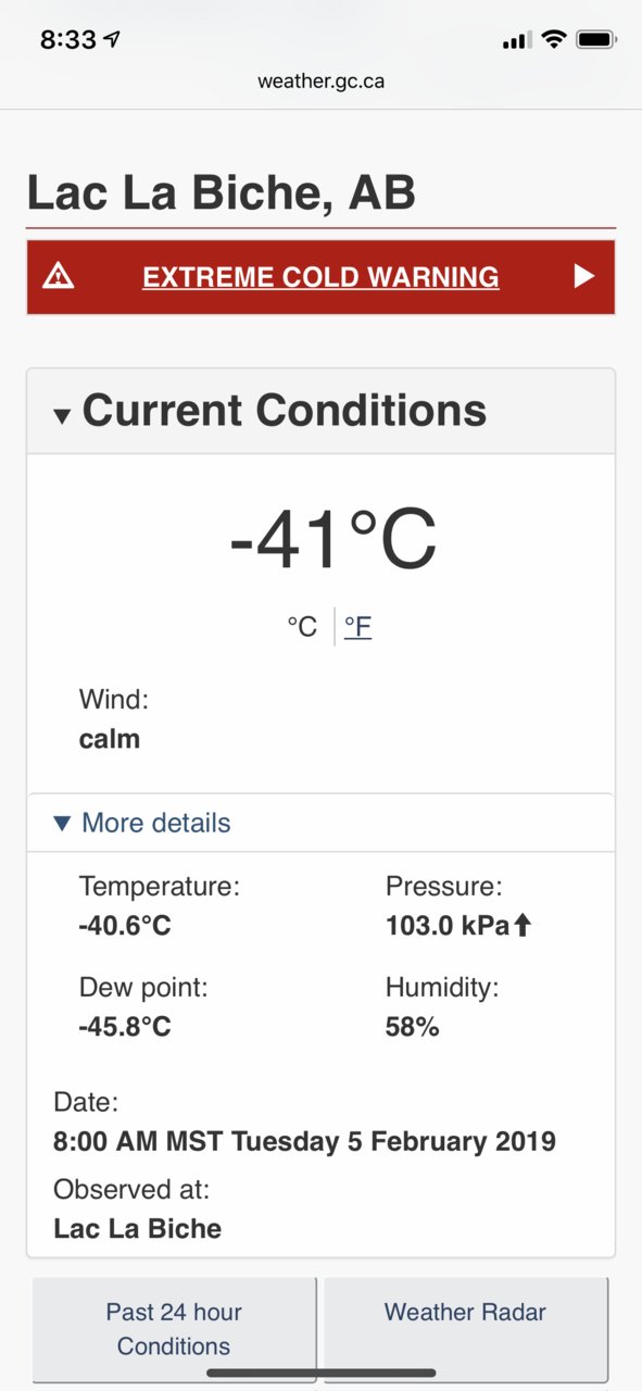

    What do you guys think of leaving a battery blanket on with the block heater in really cold tempatures? I have read you should have them on a timer? Will leaving it plugged in all night damage my battery?
