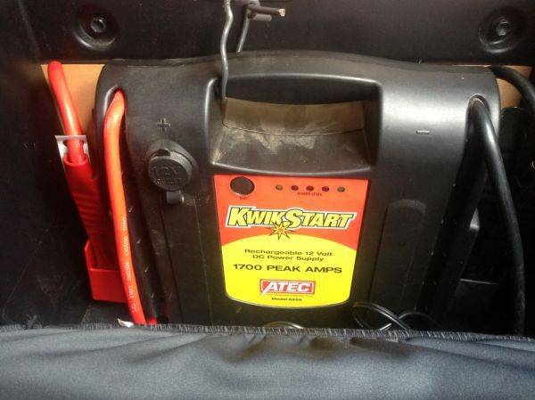

    I keep this one behind my back seat
    KwikStart 1700 Peak Amps
    KwikStart 6255 Power Supply 12V Jump Starter, 1700 Peak Amps
    KwikStart 6255 Features:
    Exclusive Heavy-Duty Sealed Lead Acid/AGM Battery provides Best in Class
    Performance
    Built-in Charger recharges unit with AC cord (included)
    Instantly Jump-Starts WITHOUT the need for another vehicle
    12 Volt DC Accessory Outlet to Power and/or recharge DC Electronics
    1700 Peak Amps
    LED Battery Status Indicator
    32in. Heavy-Duty Cables for True Portability and Technician Ease of Use
    Unit includes DC to DC cigarette lighter cord
    Patented
    KwikStart 6255 Specifications:
    DC Output 12 Volts / 442AH
    Peak Amp Output 1700 Amps
    Cold Crank Amps 360 Amps
    DC Leads 32in. 2AWG Copper
    Limited Warranty One Year
    Shipping Dimensions 11.50in. x 18.00in. x 4.25in.
    Weight 22 LBS
    Internal Charger Automatic Internal 500mA
    Battery Heavy Duty Sealed Lead Acid/AGM

    1700 amps output is overly optomistic. At a 100 amp load, the voltage drops to 9 volts. Not enought to start a truck if the battey is dead.

    Huh , worked great both times I used it

    Then your battery wasnt dead.

    360 cold cranking amps won't start a dead vehicle ?

    Yeah, that should, but the specs on that booster arent true. Like I said, a 100 amp load drops voltage to 9, which might start it, but it would be a slow start. The 1GR-FE will crank slowly at 10 volts or less. Less than 9 volts, and start up is a gamble.

    Not sure I'm following you
    You're saying the specs that say it has 360 cold cranking amps are false ?

    According to their own literature, a 100 amp load drops the voltage to 9. The starter will place more of a load than that on the unit. If it was as powerfull as they state, a starting load wouldnt drop the voltage below 11.

    Where did you find that ?

    Google search. Also, talking with a friend of mine, who happens to know a thing or two about batteries, he mentioned that they are listeing the "SHort Circuit" amps, which would make sence. as Odyssey batteries have a 3100 amp rating in that catagory.

    There is more than one model , sure you got the right one ?
