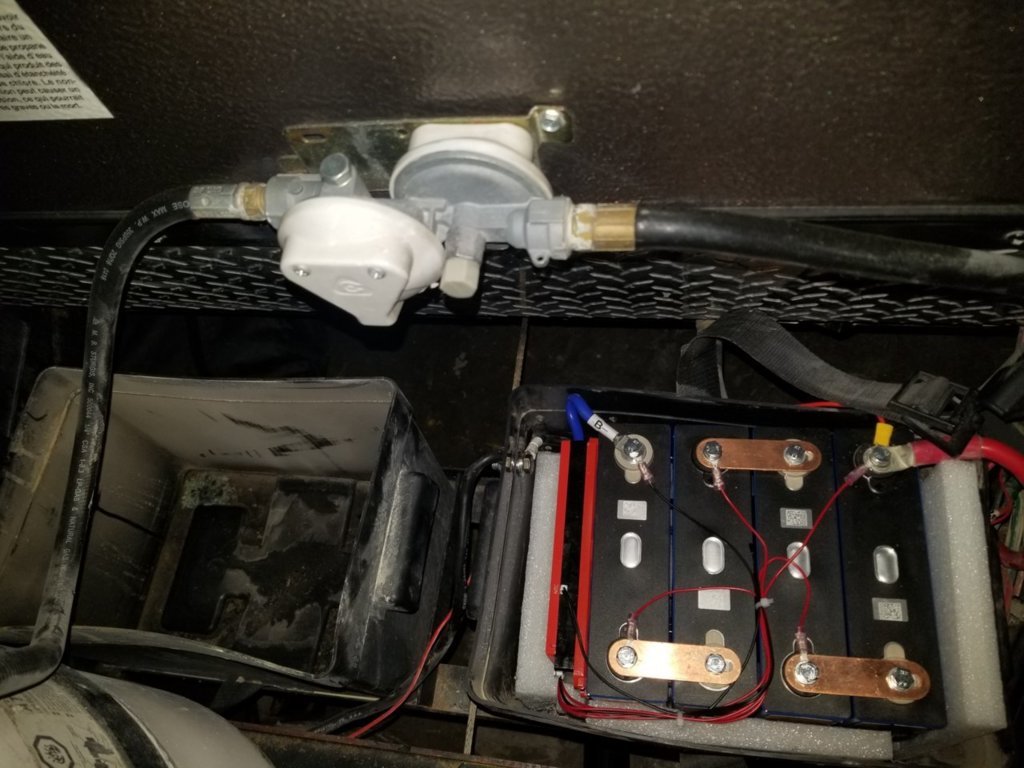

    Lynx (no name chinesium, build-a-block cell style), versus the equivalent amperage lead that it replaced. I bought this in April 2021, it sits out in the elements in a plastic box, I've frequently discharged it below 20%, and yet it still retains full charge capacity. It's treated me well.
    I didn't think there's much reason to go brand name with lithium iron phosphate. If they're bad, you'll usually know it before the return window expires.
