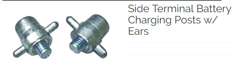

    I had a similar issue with my Group 31. A set of SLEE terminals not only solved the problem, but made it way easier to manage my winch, fuse block, etc.
    Can't find a photo of mine, but here is another member's:
