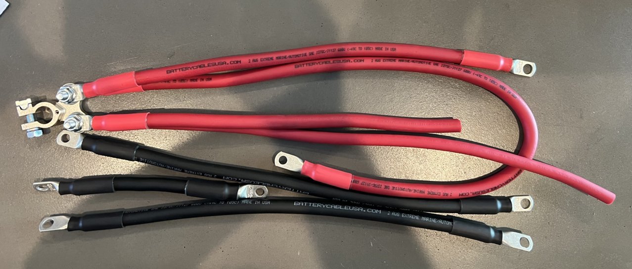

    C31DC50D-3CC1-4840-90E9-32AB3357E9B8.jpg I finally caved in and decided to upgrade my battery cables after putting it off for so long. After looking at my options, I settled upon BatterycablesUSA.com.
    They provide the option of creating your own cables custom cables using the various cable types and end fitting options. I selected their Extreme Battery Cables which is made from pure oxygen free copper, for marine and automotive use.
    I received them today, and I am floored by the quality. I hate paying for someone to terminate cable connectors, but for the cost paid, it feels like the labor was free, and all the cost is in the quality materials. Finally, I have found battery cables where I don’t feel like I’ve been ripped off after purchasing them. Can’t wait to install them.

    I've been thinking about making my own cables but after looking at their prices I might order from them. Would you mind posting up the lengths and terminal sizes for the main 5 wires there? Also curious where you found that positive top post adapter, I don't see that available on their website. Thanks!

    Here you go.
    Cablesize, length, connector 1, connector 2
    Batt+ to Alternator: 2GA, 30”, M8, M10 - This can be as short as 24", I needed 30" as I routed it differently than stock.
    Batt+ to fuse box: 4GA, 20”, M8, bare - This can be as short as 16", I needed 20" as I routed it differently than stock.
    Batt- to fender grounding: 2GA, 8”, M8, M10
    Grounding Engine to Frame: 2GA, 12”, M8, M8 - Added this ground connection.
    Grounding Engine to Cab firewall: 2GA, 18”, M10, M10
    The other cables were for my winch solenoid and stereo fuse holder.

    Yes, the cable upgrades are so good for the electrical system.
    I paid $68, for some badass cables. So worth it.

    All of those custom cables cost me $68. And it’s pure OFC too.

    That battery terminals are Unilug Two Up from Australia. Badass terminals that I also run on my dual battery setup on my FZJ80.

    anyone have a walkthrough of doing this upgrade? I wanna upgrade my wires but just wanna make sure I do them right

    Oct 17, 2008
    #10028
    273
    Portland, OR
    '04 4x4 TRD Off-Road Limited
    All-Pro lift, Addicted tube bumper, Revenge sliders, stuff and crap
