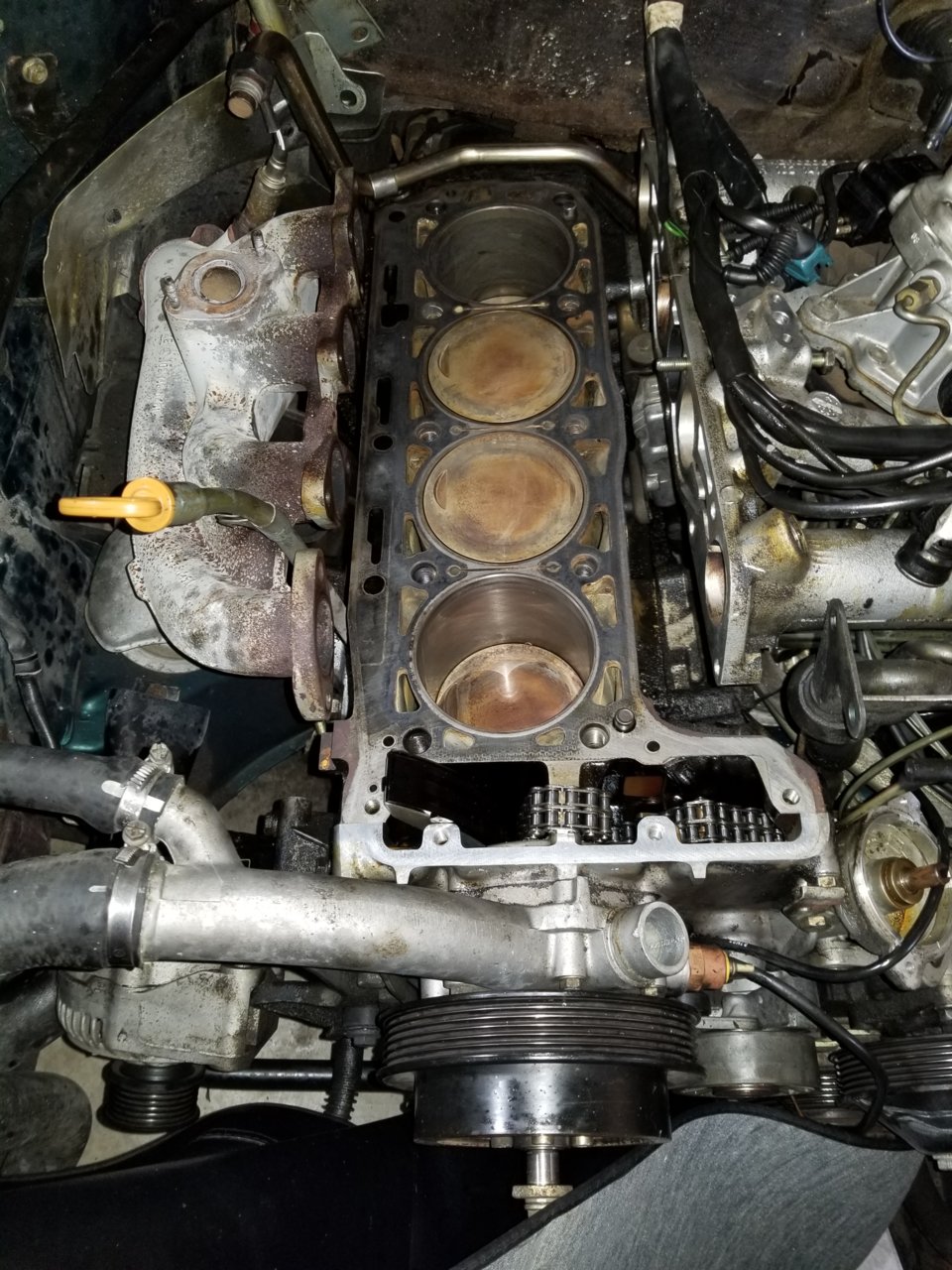

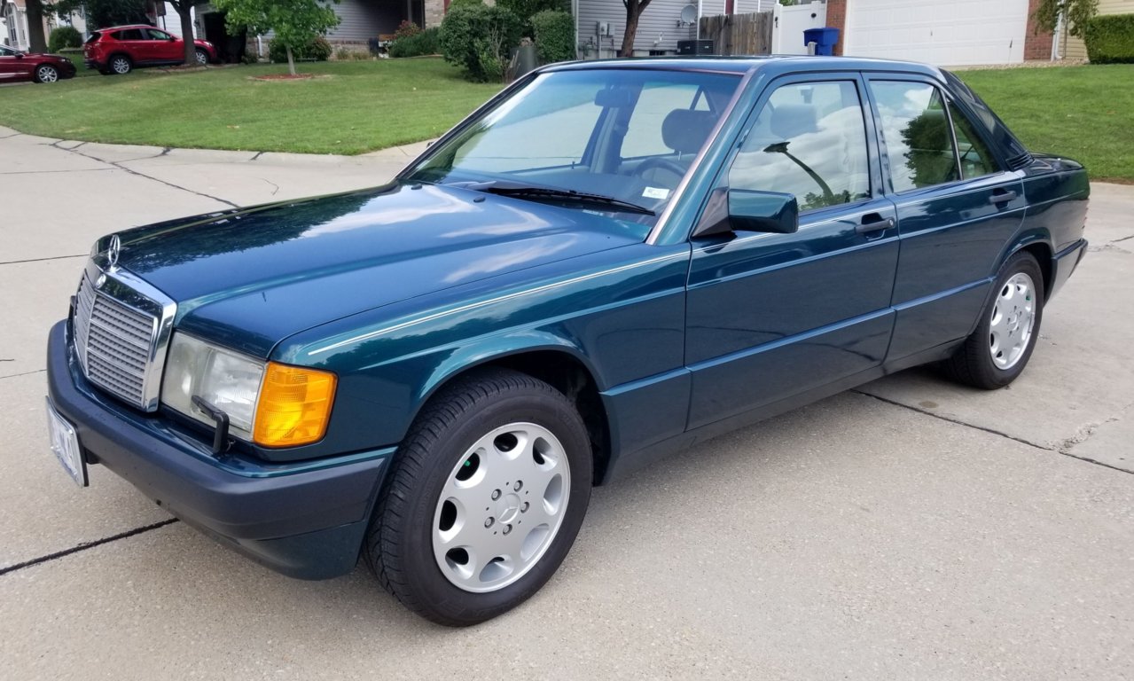

    That's a slick old Mercedes you picked up. I bought and sold a '98 E320 and '93 190E this year. I bought the 190E with a blown HG among a few other problems. It was purring like a kitten when it left with its new owner.

    yea i like this little car. needs ALOT of work. including an engine rebuild or replacement. which is much harder than i originally thought it would be. oh well. eventually.. I've got all the original paper work, the original plate from new york when it was new, and its mostly a complete car. just has a valve touching a piston is all...

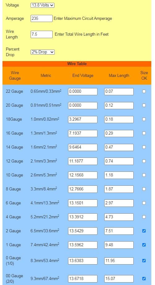

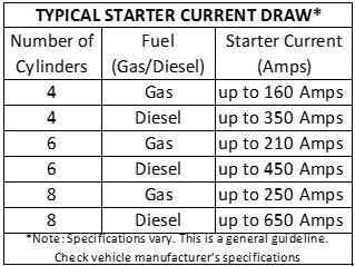

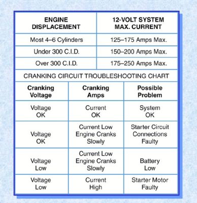

    2/0 is overkill for this application though it's fine on V8's or high-compression engines (especially diesels). 1 AWG will even work fine on most V8's. I look at peak and nominal starter current draw when sizing cables.

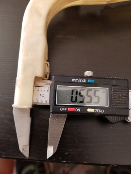

    The problem here is with routing. As size goes up, routing becomes more difficult obviously. In this case, the positive cable and solenoid wire need to run in the plastic channel attached in front of the oil pan. Nominal OD of 2/0 TEMCo welding cable is .564". The width of the plastic channel is about .555". Then it gets tighter through the elbow.
    Then there is the problem of stiffness. SGX is stiffer than EPDM or PVC-jacketed cable, but it is more resistant to heat, chemicals, and oil than EPDM or PVC. SGX lasts longer than the others as well. That's why I will be using it for the positive cable. Since it routes through an area that is often contaminated with oil (mine was), I won't use EPDM here. EPDM for the ground is a different story because of routing and where it attaches on the driver side of the engine, not likely to get saturated by oil. Also, if the positive insulation fails, you get a shorting (maybe welding!) event. If the ground insulation fails, it's not typically a tragedy.

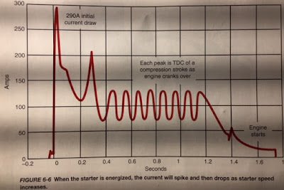

    Considering the OEM (+) cable is close to 2 gauge and the OEM (-) cable is about a 4 gauge, making mine with both cables 2 gauge will be an upgrade, since cable sizing must be done keeping in mind the total length and size of both cables. The ground cable is 38" and the starter cable is 52", so the run is 90". That is gives us 235 amps at 13.8v with a 2% voltage drop.
    Since the initial current draw is for such a short period, sizing is not based on that. Continuous current is the ticket. Sample graph:

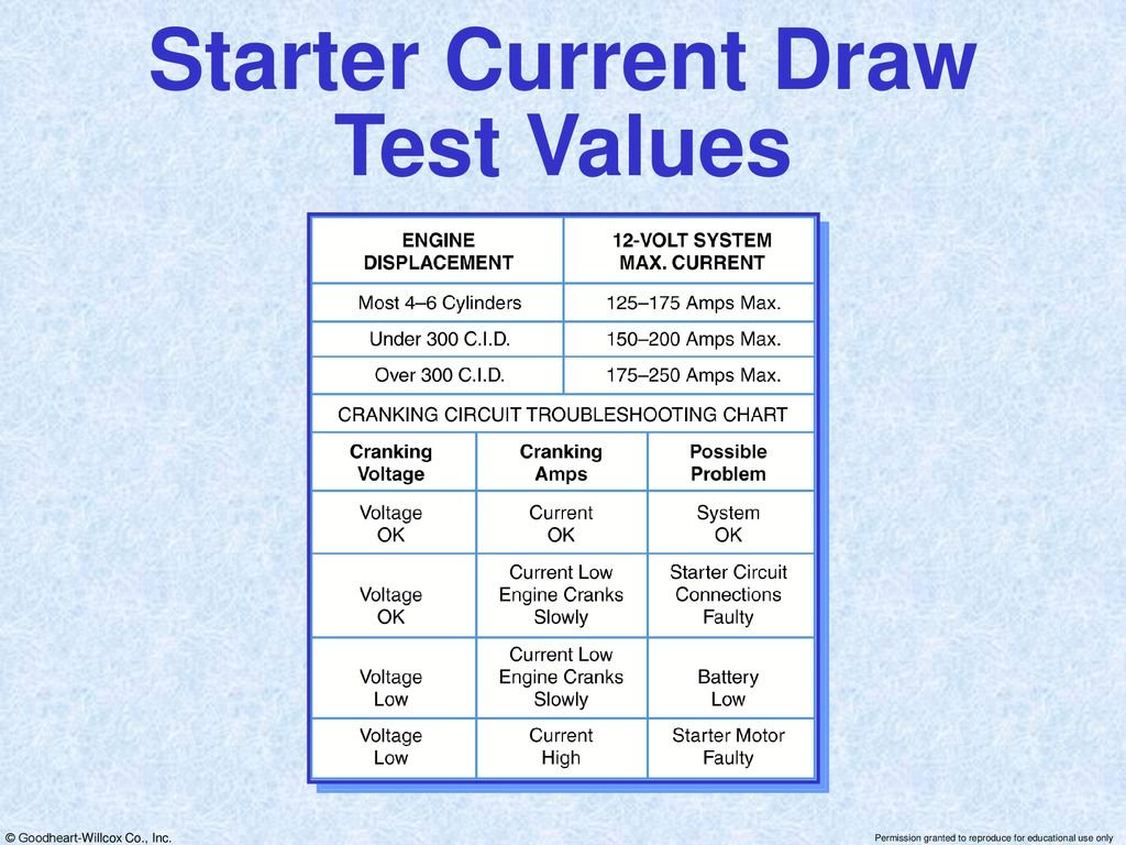

    A couple of starter current charts off the net that have worked for me so far:
    When I began making cables for Porsches almost two years ago I did a deep dive into this. Until two weeks ago I was a commercial/industrial electrical prototype technologist at a big company everyone has heard of but I choose not to name publicly. It was time to part ways. I was no longer in the mood to deal with crybaby engineers and directors that had to return to work three days a week after sitting at home for a year and a half while all of us "essential" serfs were still there. Man, did they ever come back pissy! I'm likely taking a little time off (until end of next summer) to finish a BSBA. Only 21 credit hours to go and I don't want to run out of steam. I'm 53 now and it has worn me slick going to school while working full time for the last 2 1/2 years, running a side business or two, and working on and flipping four cars in the last year. Slowing down a little I guess.

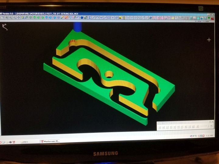

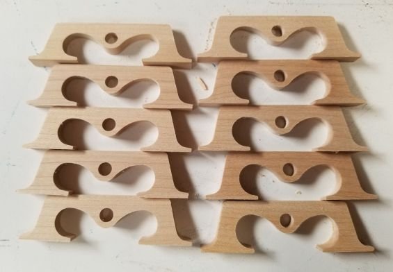

    Gracias. It's a part of many things I do having been a toolmaker/machinist/design engineer since 1993. Here's what I was making yesterday (banjo bridges). This was after the initial sanding after CNC routing. Next they get CNC-cut string slots, slot filing by hand, and then finish sanding, weighing, and marking. It's not a lucrative venture, but it has helped pay for some tooling over the years. It was a hobby that got out of control after I made my first bridge for my own banjo. Now there are over 1000 of them out in the wild.

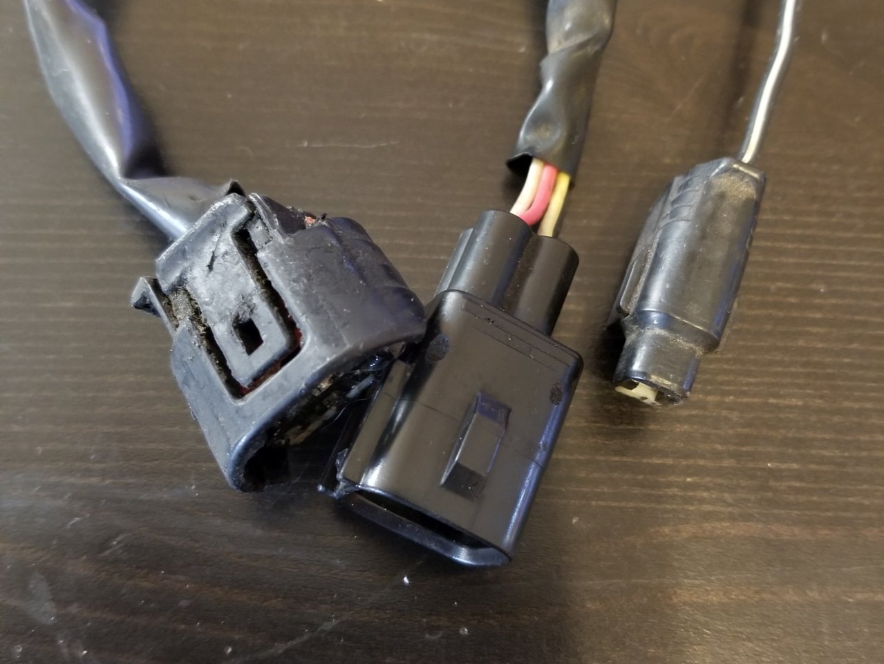

    I was able to source the three connectors to make the alternator/starter solenoid harnesses this morning. It only took about two hours of scouring the internet. They are ordered and hopefully what arrives is correct. I am now sizing and ordering wire for this part of it. Delivery date for AS connectors is by 25 October. I will make the cable sets before then. As soon as my next shipment comes from Remy Battery, I should have everything to do the cable sets.

    These plugs will only plug in to their correct sockets luckily.
