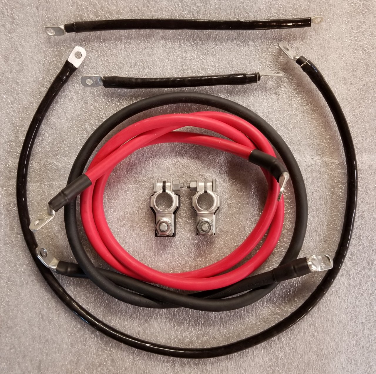

    Finally... I'm putting my harness back together now. It's all new cable/wires except for small wire harness (exciter/alt sensor/solenoid). When those parts arrive I will offer that as well though mine was in pretty good shape for being 25 years old. Toyota spec'd good stuff from Yazaki. For now, the kit consists of the five larger cable/wire components: 2 Gauge SGX (+) and EPDM (-) battery cables, 6 Gauge EPDM chassis ground, 6 Gauge SGX alternator-to-fuseblock, and 8 Gauge SGX battery-to-fuseblock. The three small cables are all sheathed in Nu-Sleeve SG-200. Adhesive heat shrink seals all ends.

    Here's the kit:

    and all this will fit in the factory wire loom plastics?
