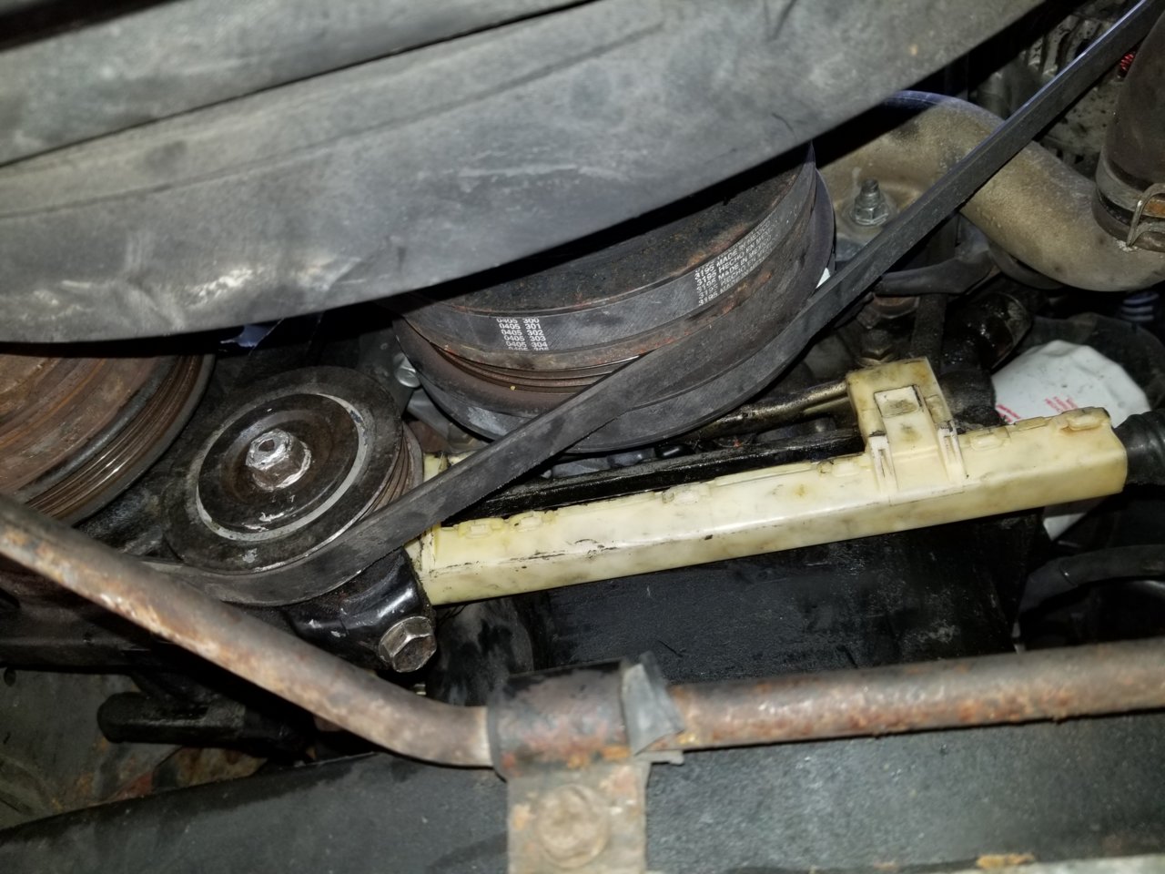

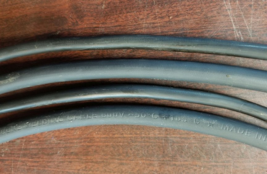

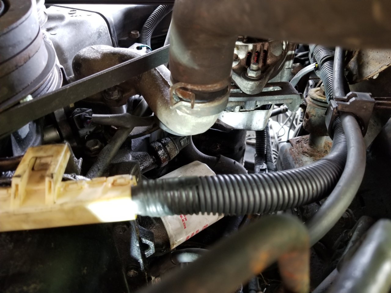

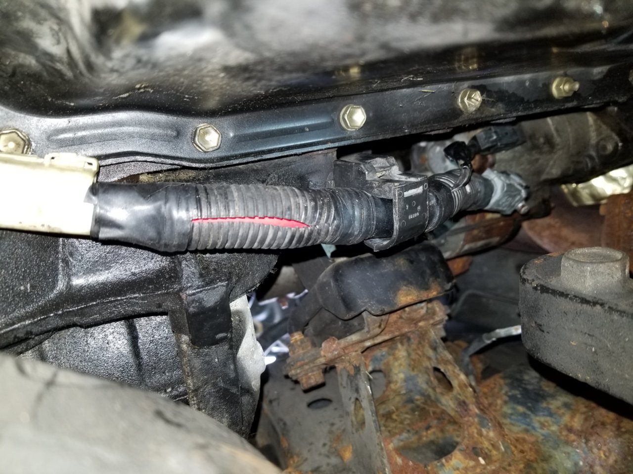

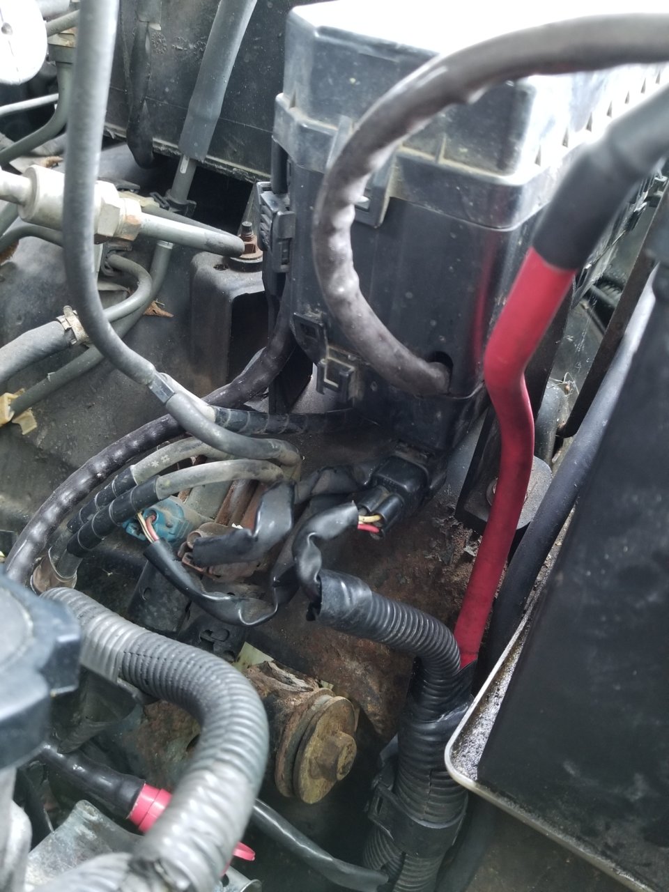

    The SGX (+) battery cable is a tricky install and may not be for everyone. It's the best but it is more difficult to route. I am switching to BLACK #2 Flex-A-Prene by default (because I have a bunch of it). Anyone who wants red or black SGX can have it - Just know that you've been fairly advised. It is harder to work with. They carry the same current.
    I installed the loom on the starter side like it was OEM. Here's how I did it on the alternator side:
    The old stuff was chewed up and I just used what I had laying around. I don't use split loom on my Porsche stuff so this is all I had.
    You will notice that neither the battery ground is loomed, nor the alternator cable. Since the alternator cable I'm using is bigger and stiffer than OEM, it can't turn back on itself in the loom like OEM. I would have loomed the ground cable but didn't have a long piece of new 7/8 split loom (like the short section on the right).
    The alternator cable will not be the OEM length as a result of the above explanation. It will be about 16". Here's how that works:

    Front:
    Alternator side:
    Top:

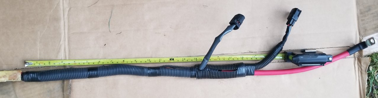

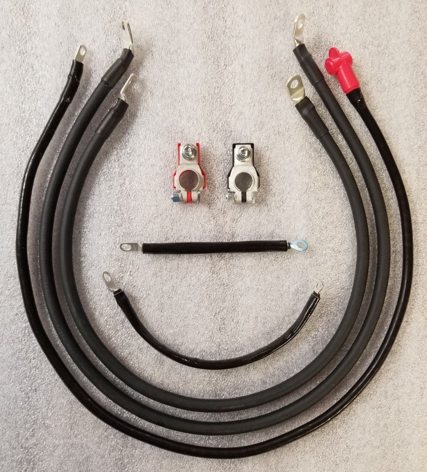

    First set of 2.4/2.7 cables are done. They are officially for sale and will be on my website and ebay later tonight or tomorrow. Anyone who already PM'd me is in at $120 shipped.
    A big thank you goes to col. sandurz for sending a good OEM harness for me to reverse-engineer. He's getting the first set of new ones in return.
    Here's the difference in 2.7 OEM battery cables versus these:
