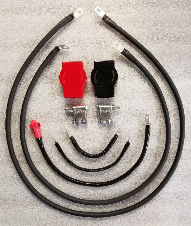

    These are beautiful!

    Rust and manure and new battery cables.
    Gracias!
