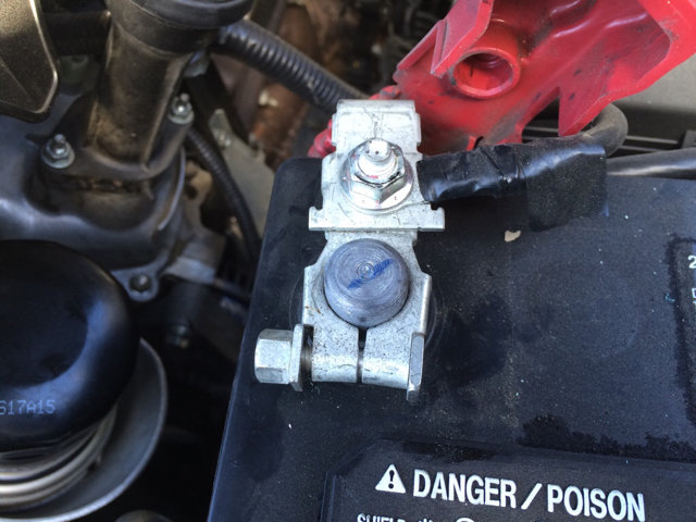

    Do I need to unhook both of these first on the negative side? Or just the on the left?ImageUploadedByTapatalk1445802248.044800.jpg

    That is the positive side, the side with the red cover. The left side or side without a red cover, is the negative side. From the looks of it I dont see any benefit in removing the cables. Its not that bad. I would just brush it just how it is.

    Also, idk if I'm seeing this correctly, but your positive terminals tighting nut looks loose. Check that.

    Christ the guy at O'Reillys told me red was negative. Ok retightening now. I may just leave them on and brush around it
    Thanks!

    Annd thats why I don't trust auto parts stores.. Yes, just tighten it back up and brush both terminals without removing any of them and re "clip" that red cover back on the positive terminal.

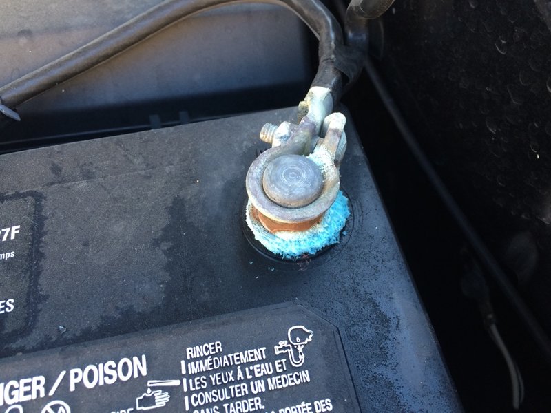

    Remove them. Its the interface between the posts and conectors that makes the electrical connection. Use a battery brush ($3 or $4 at any auto parts store) on the posts and connectors to remove corrosion and the layer of oxidation so you see bright shiny metal where the parts make contact. You will also want to wet the top of the battery and the connectors (I use a spray bottle but a hose or pitcher of water works) then sprinkle on a layer of baking soda. Give it a few minutes to work then rinse (flood) it really well with water. Baking soda and water not only removes/neutralizes acid and corrosion, removing the layer of gunk also stops parasitic drain between the positive and negative posts.

    This. Standard practice when I find corrosion. Then a thin coat of dielectric grease to posts and terminals and done.

    No you don't need to do both of those- just the one on the battery terminal. The other will come off with it. But that positive one looks pretty clean.

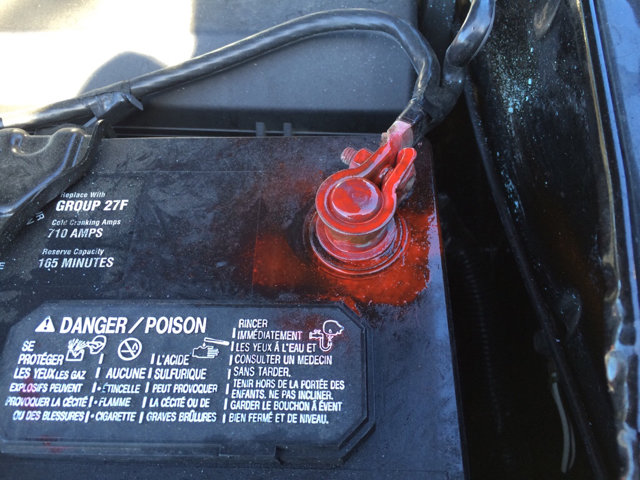

    Boom. All clean. Probably didn't need the $7.99 "kit" but it's better than $55ImageUploadedByTapatalk1445803471.690857.jpg

    Or of you want to get a deep clean do this. I just have always wire brushed mine either while it was connected or disconnected depending on how bad it was, never had a issue after

    Vaseline is completely useless because its melting point is within a few degrees of 99F. It gets much hotter than that under the hood of a vehicle. IMO any kind of grease is unnecessary for battery connections. A bit of the red anti-corrosion spray is plenty good enough.
