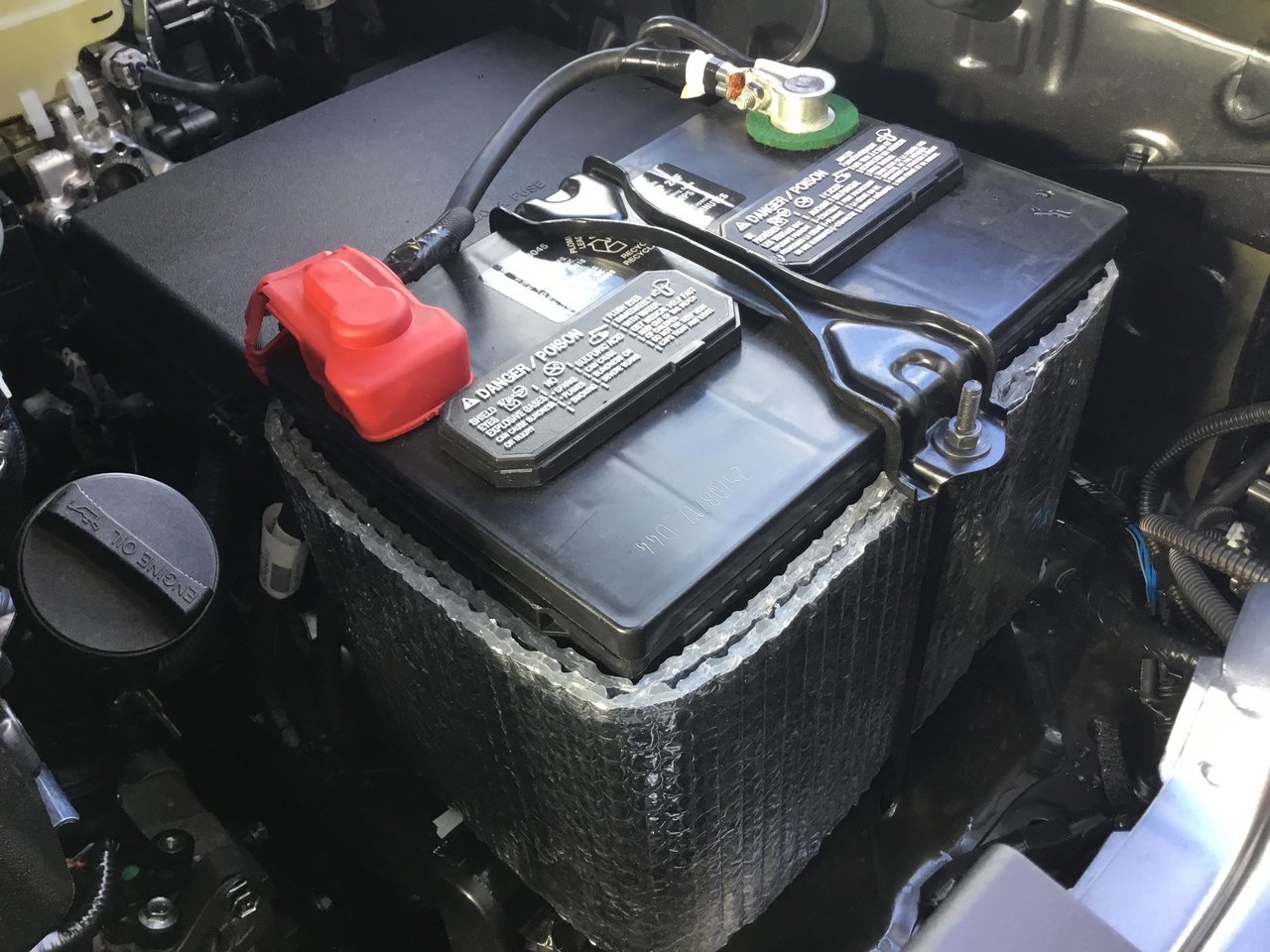

    Along with everything above, grease or battery rings cost a buck or two. I’ve had no battery corrosion problems during many years of using them.

    Love the HVAC bubble wrap mod :)

    What's the purpose of those rings? And also do you grease the terminal or hust the connector?

    Those red and green anti corrosion rings to slow down the battery terminal corrosion. Keep an eye on your terminals nonetheless.
