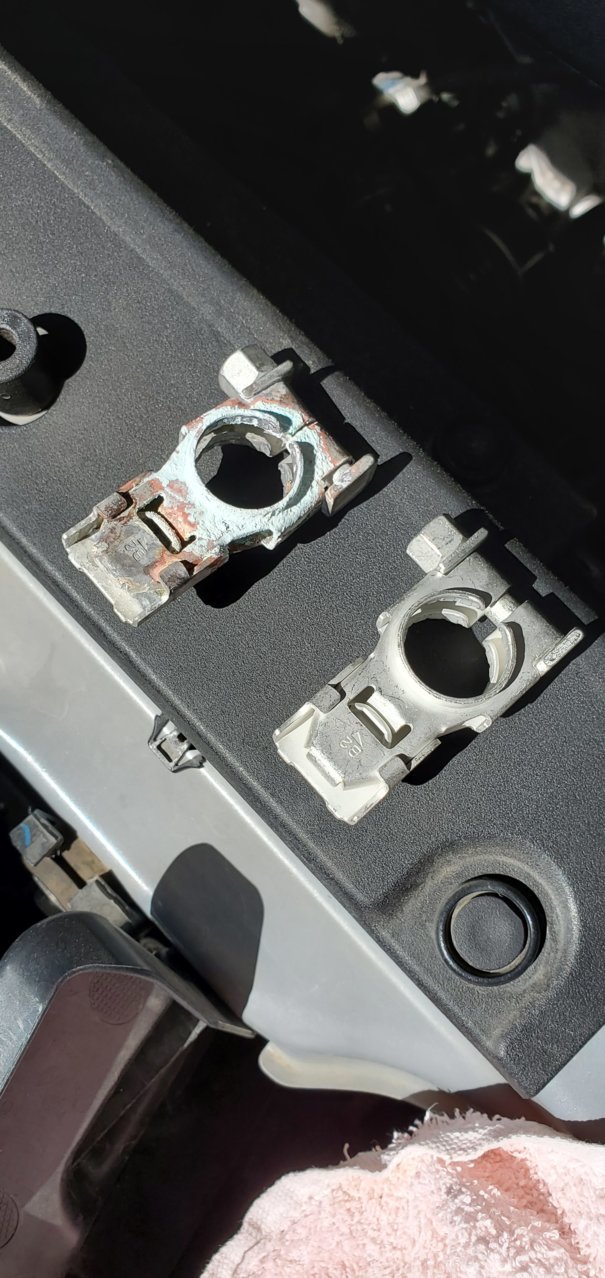

    My truck only has 15K whith no electric modifications so I'm a bit surprised my positive terminal looks like shit. I do live in 110F summer weather maybe temp plays a role?

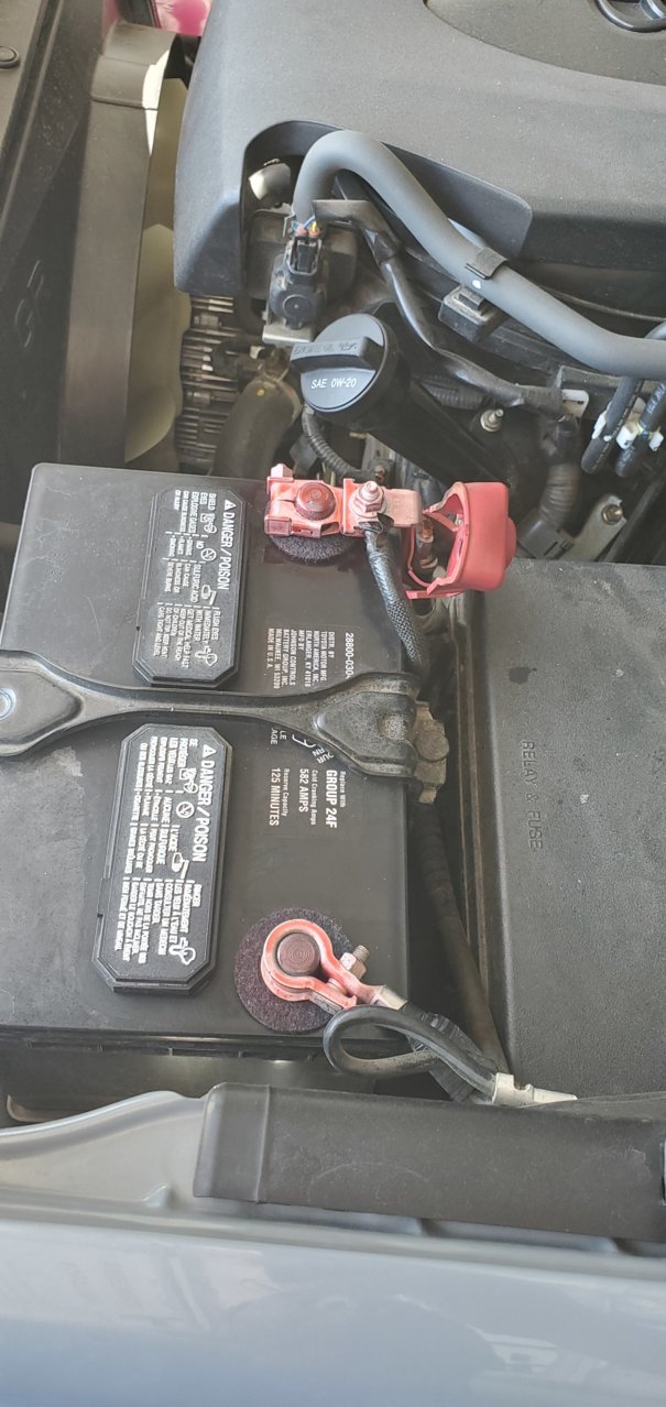

    Let hope the rings work and the spray prevents future corrosion

    I soaked it in terminal cleaner and I did notice the copper coating the top coating was burned off .
