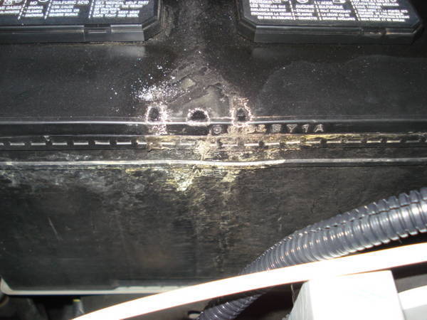

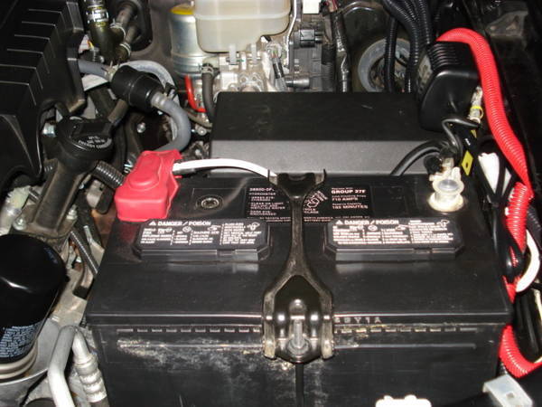

    Well, yesterday when I was installing my PIAA's lights ran into this - Cracked Battery on the Side:
    Does not look good. This is the OEM battery, and the metal bracket over the top appears has crushed the battery over time causing it to start leaking acid recently. I should have paid closer attention - :frusty:
    Normally you would see this type of problem around the terminals, but this very fist time I have seen this issue on any of my previous car batteries.
    I mounted the battery back and was careful not to tighten the bracket rods too much. You can still see that the edge of the battery is curved due to the compression of the bracket overtime.

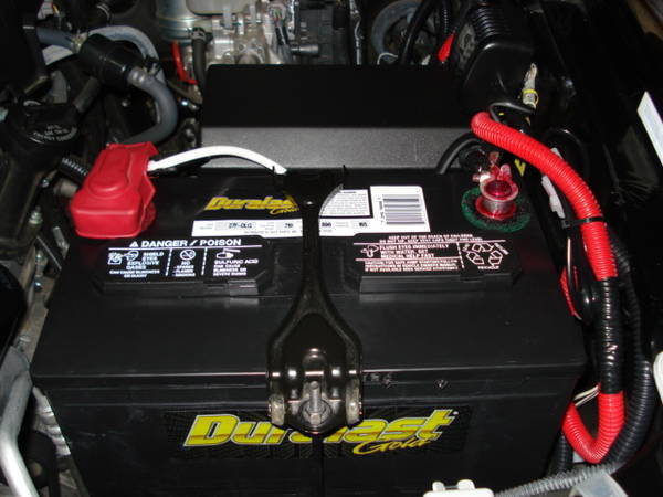

    Acid leaking is asking for trouble and will damage components in the compartment, stip paint, etc.
    My opinion of the root cause of the problem as to why the battery cracked on the side is not that the battery is of bad quality, but how tight from the factory the bracket was, that led to the problem.
    I got a Duralast Gold 27F today at Autozone - it was a good deal for $98.00, 3/36k replacement warranty with 8yr standard battery warranty. A guy in the store help swap the batteries, and told him to be easy on tightening the bracket, dont need a Herculean Torque!!
