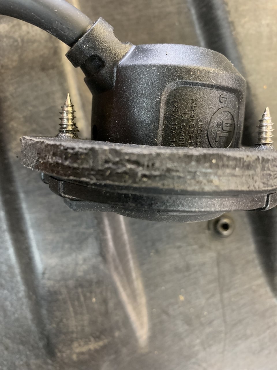

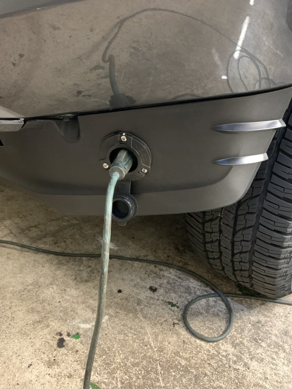

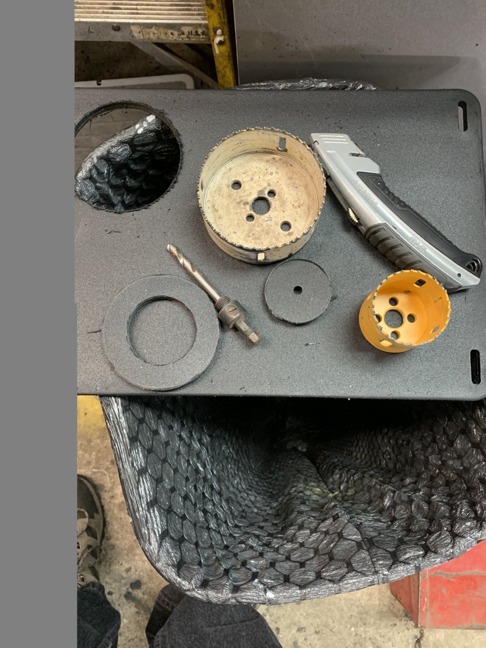

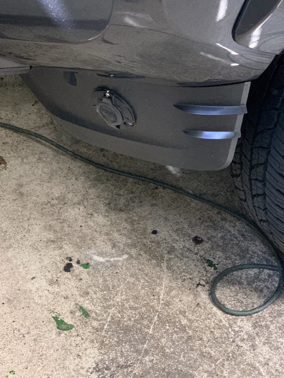

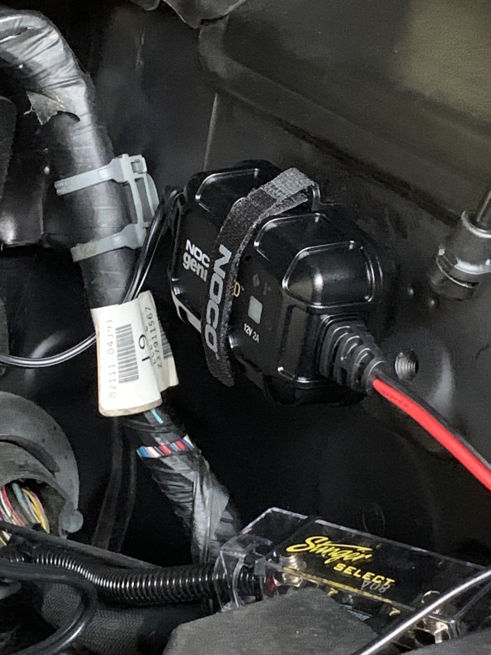

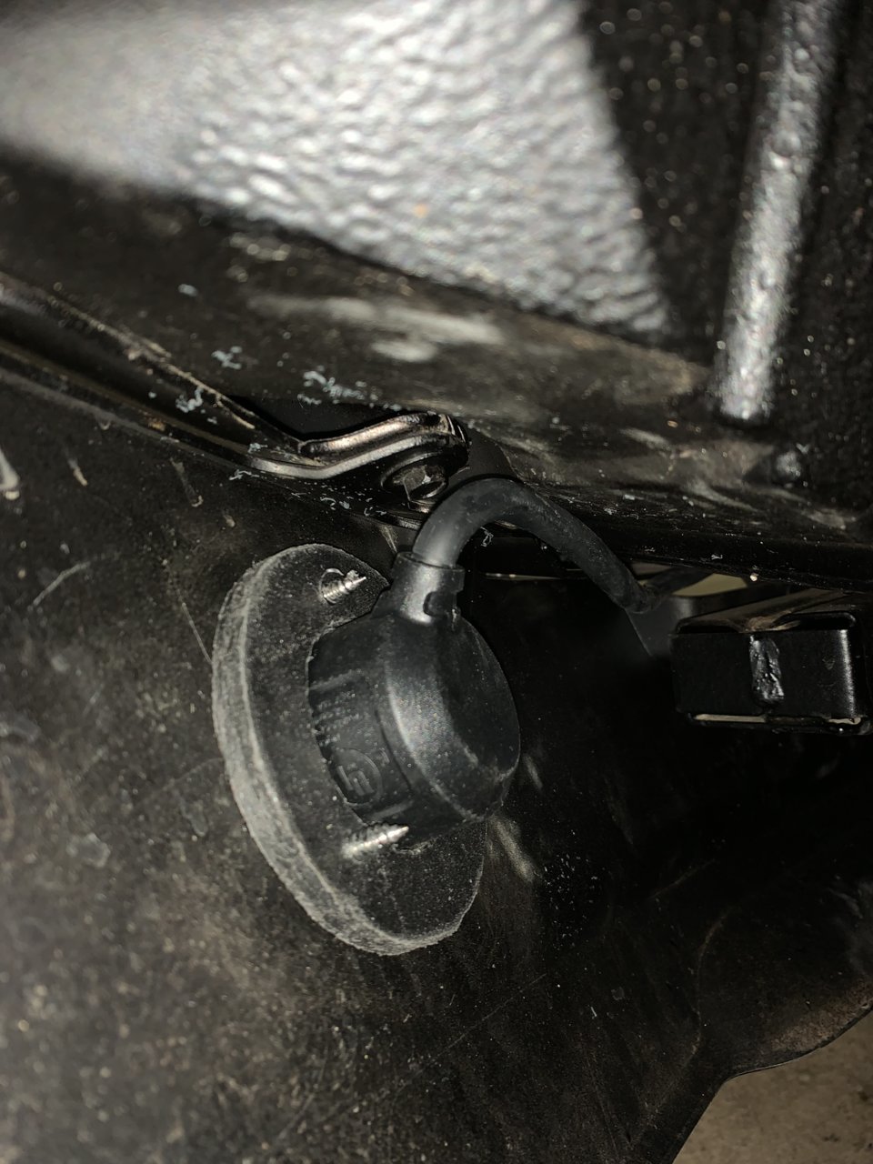

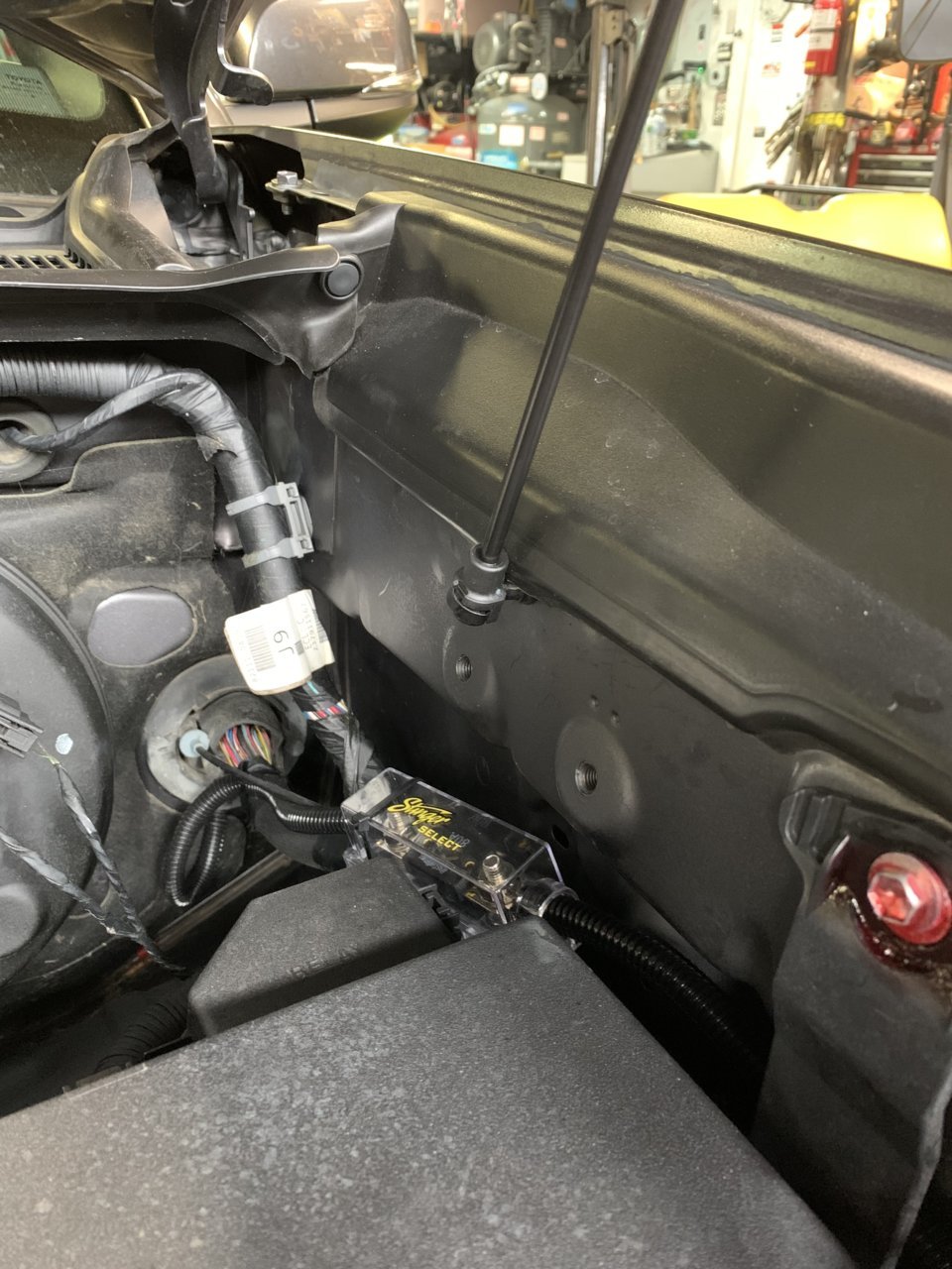

    Hello all, I have been ordering parts to finish up
    my battery Tender and figuring out where I will place the plugin.
    So I bought the battery Tender (I love this model) and the parts needed.
    #1[​IMG]
    The mounting location of the charger.
    #2[​IMG]
    Pictures say a million words.
    #3 [​IMG]
    Mounted
    I used a black plastic cutting board for a backer w/3 ss screws.
    #4[​IMG]
    Chew likes this.
  17. Apr 27, 2023 at 12:03 PM
    #17
    TacoSport4WD
    TacoSport4WD [OP] **Learning Everyday**
    Jan 28, 2023
    #416569
    6
    Mark
    Aurora IL,
    2018 Toyota Tacoma TRD Sport 4X4 / Magnetic Gray Metallic
    PMetric off-road tires, Ziebart, Seat Riser Blocks, BacFlip Tonneau Cover, Redline Hood Struts, More 2 Come :-)
    Moving on...
    #5[​IMG]
    Predrilling the ss screws into the plastic backer.
    #6[​IMG]
    All are predrilled and ready to mount.
    #7[​IMG]
    I love this spot, it just makes it look tougher :)
    #8[​IMG]
    All done!!!
