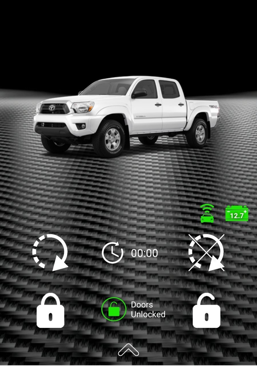

    I just checked mine. I ended up with a 24f Gold. Im running two amps for audio. I also have a remote start with an add on module for an app on my phone that is basically a parasitic drain on the truck. It seems to keep a good charge. Batteries just aren't made to last like they used to. I assume the app shows the battery voltage in case you need to start the vehicle to charge the battery?

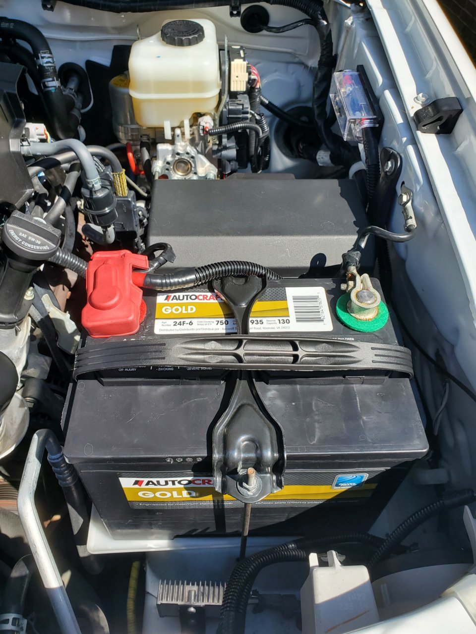

    Need to take a picture but fits fine on the stock tray, little bit larger than what was in the truck (makes me wonder if the battery replaced during my warranty was a 24).

    Thanks, I was just afraid I may need longer J hooks as some have reported.
