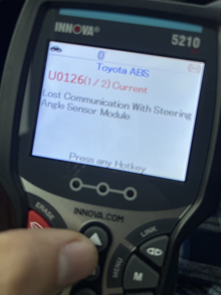

    Recently I replaced the clock spring and the steering angle sensor. Cleared up my previous codes. Great! I got like literally half a day of driving, and came back to start the truck and all I could hear was the starter click and the dash lights fade off and on.

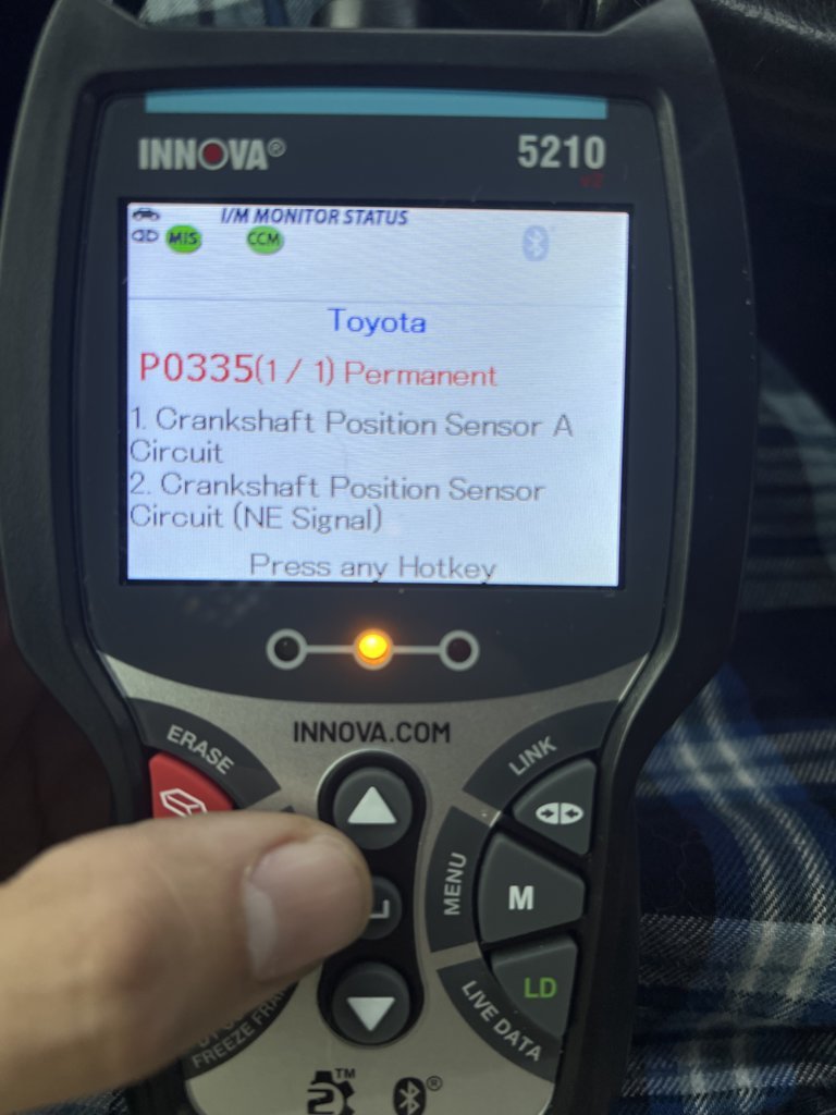

    Checked codes and now I have a p0335 code and my traction / collision light sensors are on.
    im getting p0335 and U0126(which I previously cleared with steering angle sensor replacement)
    I replaced the battery with a new one. The codes still appear and I’m at a loss for words. I’m getting so annoyed and tired of trying to fix this dam issue.
    will the codes clear themselves after awhile of driving? Do I really need to take my truck to the dealership to have them reset everything?
    I have an innova ob2 with abs and tried to clear the codes myself. No luck this time around.
    The permanent code p0335 and the U code. I’ve never had so much of an issue with a vehicle until this happened. Any help or insight! I’ve been reading nearly every post on Tacoma world but nothing that helps. Maybe someone else has had this happened?

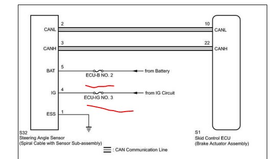

    for steering angle, check fuses
    for p0335, check harness for crank position sensor - pax side of the engine

    Thank you for the suggestion- I’m searching for the fuse location for the steering angle sensor- do you know which fuse box it’s in(engine bay or in cab?)

    ICU-B in the engine's compartment box, ICU -IG - inside the cabin's box
    You may need to check the connector on the spiral cable for any pin damage.
    P0335, does the truck run?

    as for the PO335 code- it cleared itself…. the battery must of caused this problem.

    Update: checked fuses and they both are good.
    I’m starting to think it’s because my sangle sensor isn’t an oem one.
    I wonder if it could really be that. The new one I installed only lasted a day of driving.

    Yes, logically the cable and the connector will be your next step. Pay attention to pins and the tension of the pins.
    Aftermarket parts do add a unknown variable to the equation.

    High level: Permament DTCs will clear on their own. They are there to prevent people from pulling the battery or clearing codes with a service tool to pass an inspection. That legislation came out about 15 years ago.
    You want to look for things like “active” or “pending” or “current” on a DTC to know if the problem is still there. The light will go off after two regulated drive cycles if the problem is resolved. Based on your posts above it looks like this one already went away.

    Ok update:
    thanks to everyone who replied and tried to help!
    it seems it was a battery problem.
    crank sensor was cleared on its own after driving for a little.
    Now for the SAS.
    I didn’t remove the entire steering wheel this time. I just took the screws off to reveal the sad plug. I disconnected and plugged in the oem one. That changed my code completely to a “C” code it’s read of the u0126. So I assume the angle sensor got fried or damaged? Idk but I plugged back the aftermarket sensor and left it alone. Came back 1 hour later and turned the truck on… BAM NO LIGHTS OR MALFUNCTIONS.
    the only thing different I did was connect the sad sensors WITH the parking break on. Idk if that helps but I read somewhere you have to have the parking break on to reprogram something.
    anyways that’s what I did. I’m having replacement SAS sent to me by the company I ordered with. BUT I’ll leave it alone as is- if it ever pops up with a u0126 code then I’ll just swap the new SAS I will receive.
    thanks again everyone- your input got my brain thinking differently and ultimately the errors fixed themselves after the new battery and parking break trick. Haha
