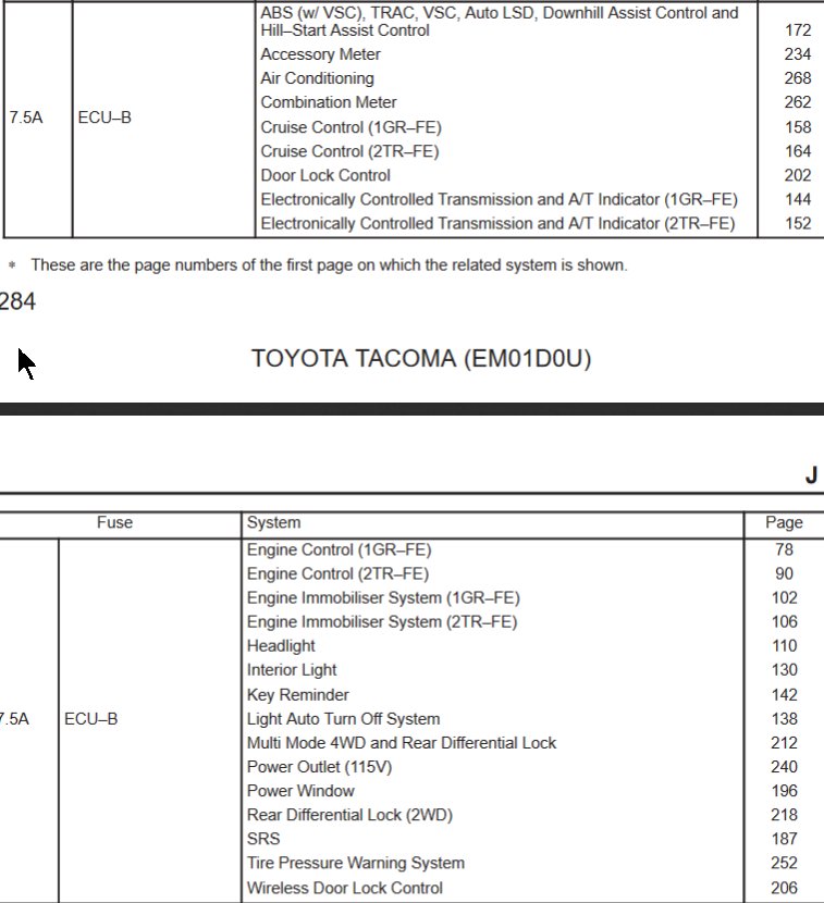

    Ecu-b pulling .7 amps and radio .9 amps with key off and out, any solutions? I almost forgot, airbag warning light on when ignition is on

    Wireless remote control, air conditioning, airbag occupant system, garage door opener. Truck doesn't have meter and gauge system or multiplex communication system

    The ECU-B Fuse Loads are here:
