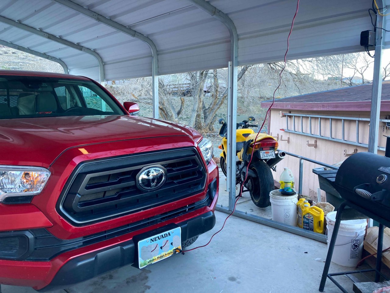

    Don't know, but I plug mine in, if I know I wont drive for a few days.
