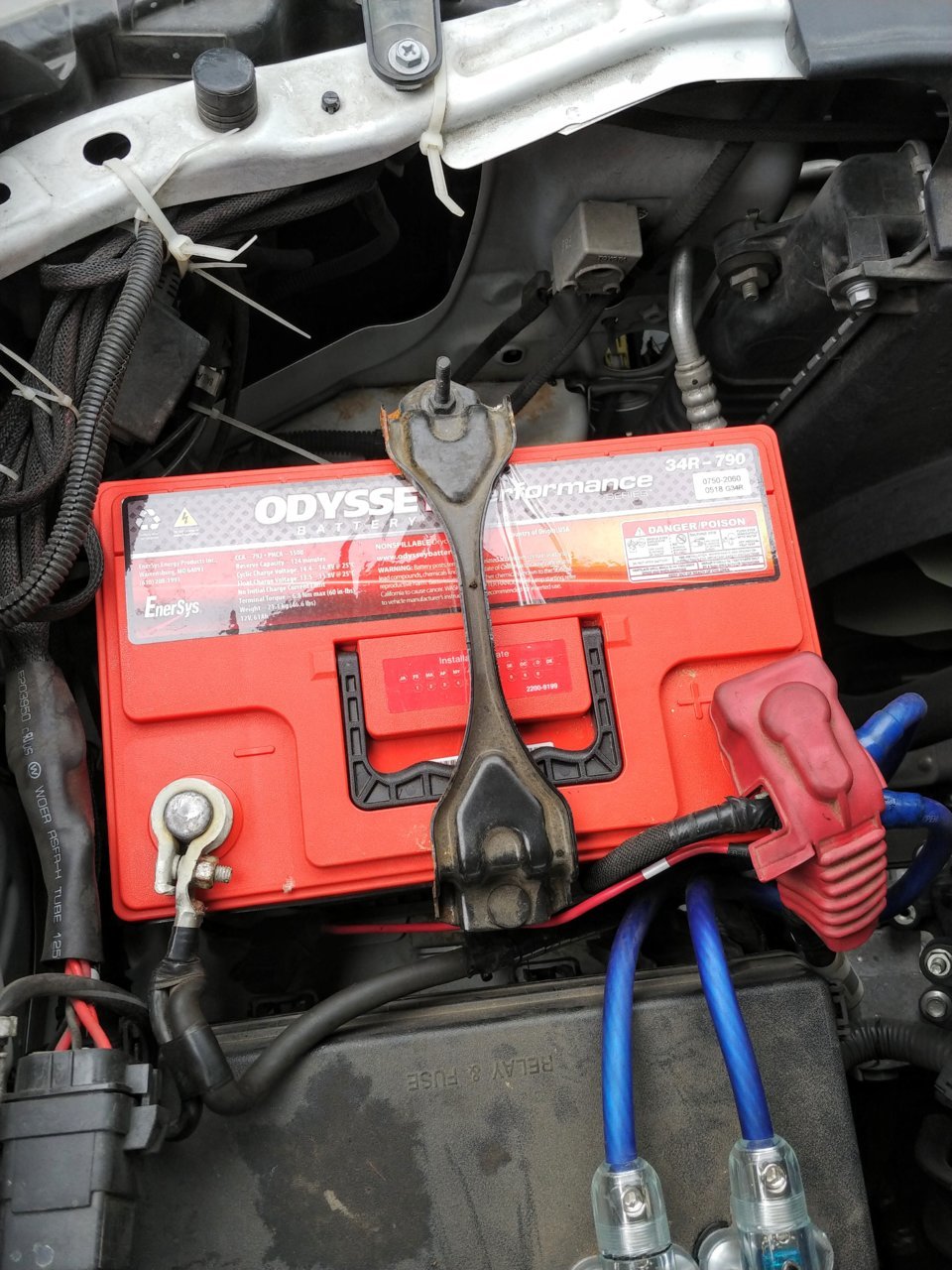

    9,869
    shakerhood and Prjct_Vodo[OP] like this.
