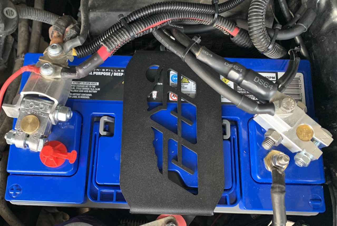

    Just installed this THICC bitch Sunday. X2 power 31M
    ScootARoot and JMS1 like this.
