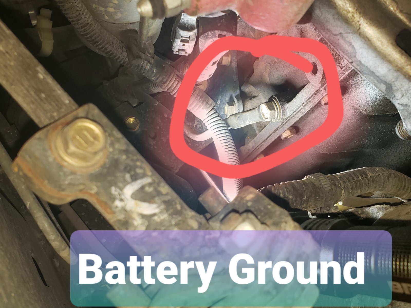

  10. Jul 24, 2024 at 7:06 AM
    #30
    wb7ubb
    wb7ubb New Member
    Jul 11, 2024
    #453103
    02 Tacoma 3RZ-FE
    For future reference the main battery ground is bolted to the engine near the transmission on the drivers side. If your underneath the drivers area looking towards the front of the truck you should see it. 2002 Tacoma 20240724_064256.jpg
