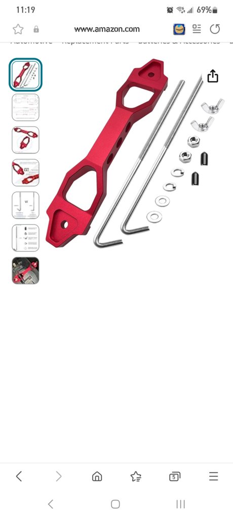

    Just wanting to know if anyone has this particular one from Amazon?
    If you do have this style of battery holder could you give me the length of the center section..I want to order a Silver TRD decal and put it there , Im not sure what size decal I need to order.

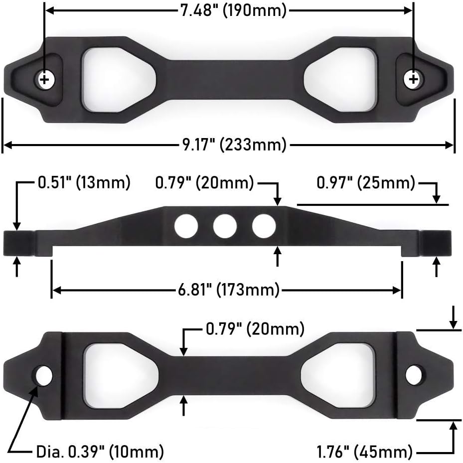

    I returned an identical Chinesium one to Amazon (sorry, never measured it), then got the USA made Agency6 hold down. It's designed to reuse the factory clamp bolts on 4Runner/FJ Cruiser, so just needed to add one Toyota part 74451-35090 'Battery Clamp Bolt' to make it work with the Tacoma.
    https://agency6.com/collections/toyota-4runner-billet-battery-hold-down-bar
    Shameless -Buy USA Made- plug aside, I'm pretty sure these dimensions are correct:
