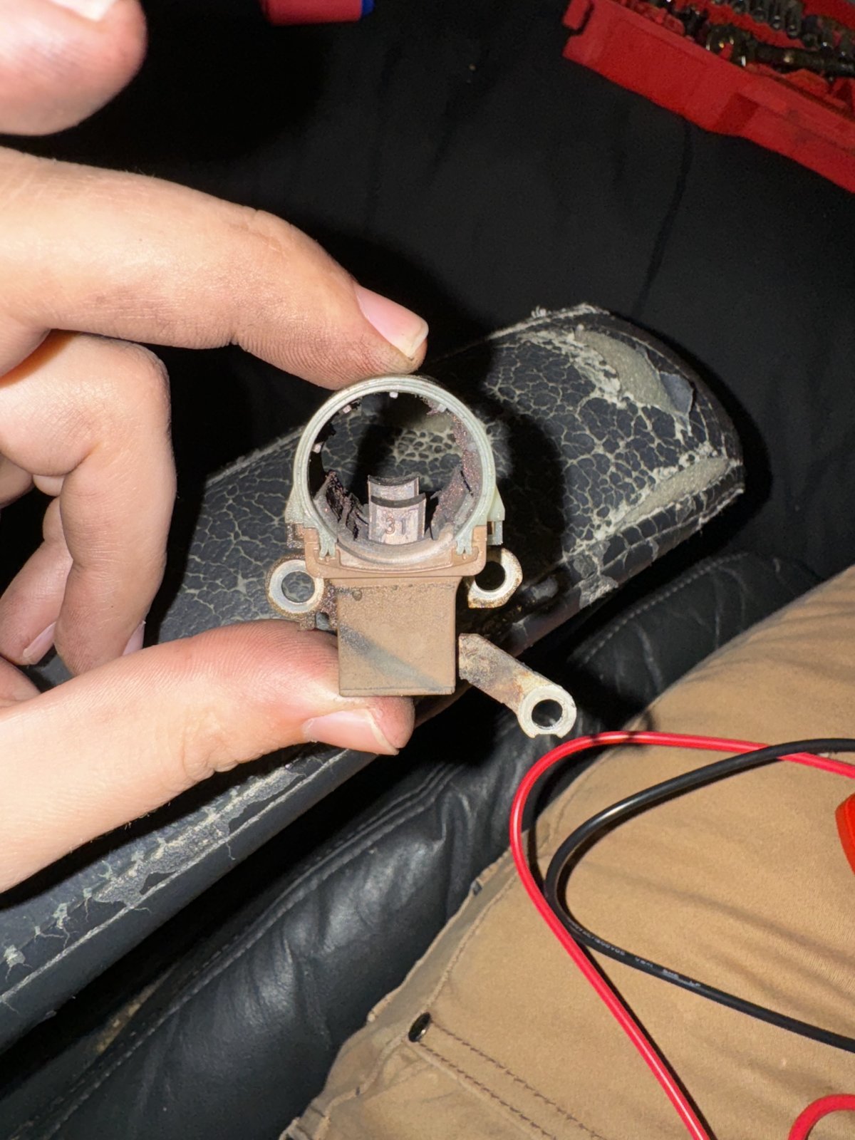

  10. Mar 21, 2024 at 11:49 PM
    #30
    donosparks234
    donosparks234 Member
    Oct 15, 2023
    #435566
    7
    Murray, Ky
    2008 2.7 L manual Tacoma
    Know it’s an old thread but it’s sounds like my problem plus some. When the battery light first came on the dash I got some supplies together and then noticed my dome light dimming and getting very bright. Then my radio would cut out. And cherry on top both my headlight bulbs and one parking light bulb blew. Both high and low beams.
    At this point I went to AutoZone to get battery alternator and starting system checked. Of course battery light was off and they said my starting system was bad?
    I know it was a fluke but at home with voltmeter with engine running it first read 15-17 volts jumping between those and then the battery light went out and then it read 14 volts like normal. Battery was normal voltage at rest.
    Decided to take alternator out and check continuity and resistance of diodes, slip rings, and b terminal. They seemed fine and checked brushes not really sure what bad brushes look like so I’ll put a picture below.
    The voltage regulator would jump between 0-3 ohms of resistance and then to 1000-1500 ohms. Not sure if that’s a fluke but I’m guessing voltage regulator is out (guessing my bulbs got a huge surge and blew) and as far as I know that part can’t be replaced and an all new or reman alternator is needed. Any agreement, disagreement, or suggestions are appreciated.
