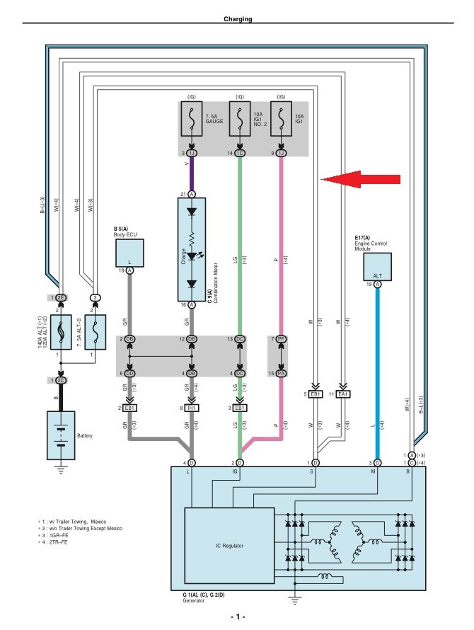

    This might help:

    Thank You
    THIS was the post that really got me thinking and shook the cob webs loose. Then, going to the reply above... kinda confirmed!
    It's been a very long (MONTHs) evolution getting this engine in. In the process, saw my Tranny mount broken, and literally nothing left of my CB! There has been so much work done... and here in AZ... it's been hot. I mention all this to try and get sympathy for my lack of attention to the BASIC F'ING wiring!!!!
    Notice, in my original post I didn't mention the positive cable from the ALT to Battery!!!! I'll get it all reassembled tonight / tomorrow adding a positive line from Alt to Batt. I don't think it should even need the NEG as the motor is grounded, and the Alt is bolted to Motor.... Yes?
    Same of course.
