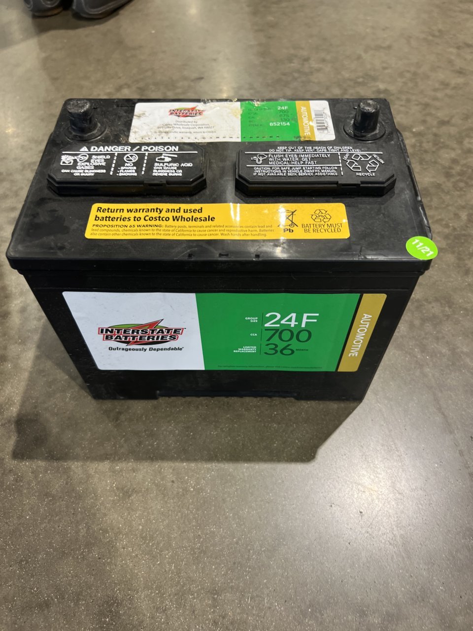

    Check the voltage on the battery before take it in. Otherwise they will probably tell you they need to charge it before they can check it and warranty it.
    it needs to be ~12.6. If you can’t get it to 12.6 or so. You can tell them it won’t charge. But I’ve never had any luck with them believing me. I just leave it and wait for a phone call confirming what I told the. It wouldn’t charge.

    How much did you pay for that?

    I’m not OP. But my Costco sells that battery for $93.99
    OP, if you’ve had 3 batteries fail in 2 years. And the last 2 failed with in 4 months of putting them in. That’s a bit suspicious. There could be something killing the batteries prematurely?
