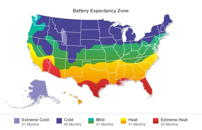

    What region are you in? For most of the USA you can expect less than 4 years. Particularly hot areas will see less than 3 years:

    Delaware resident here…in the green zone.
    We have 4 seasons.
    About to go through 4th summer.
    No corrosion on my battery terminals.
