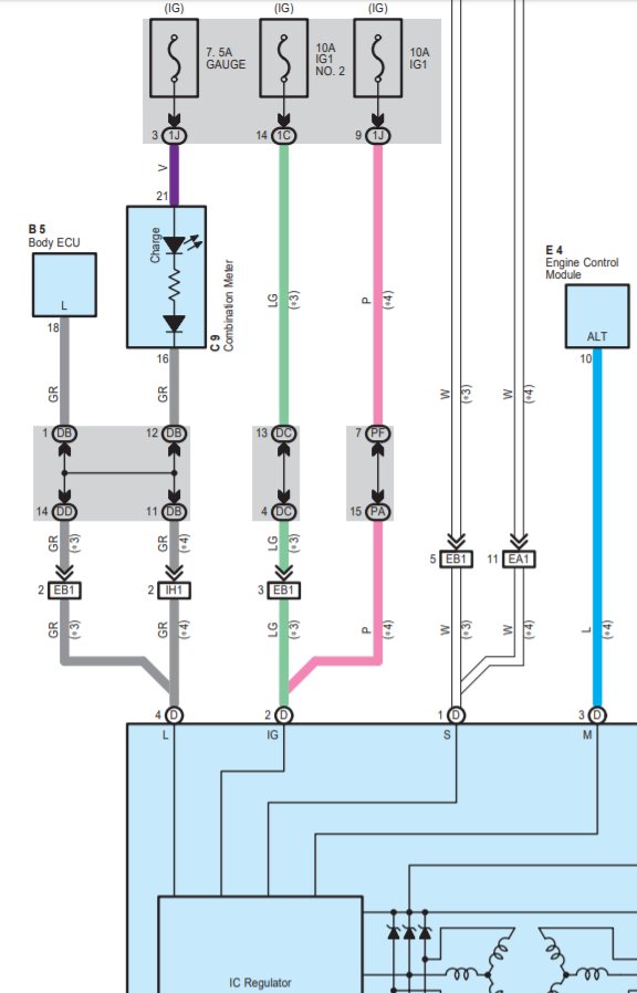

    Check the G2 connector, namely pin 4, and associated wire (gray)
