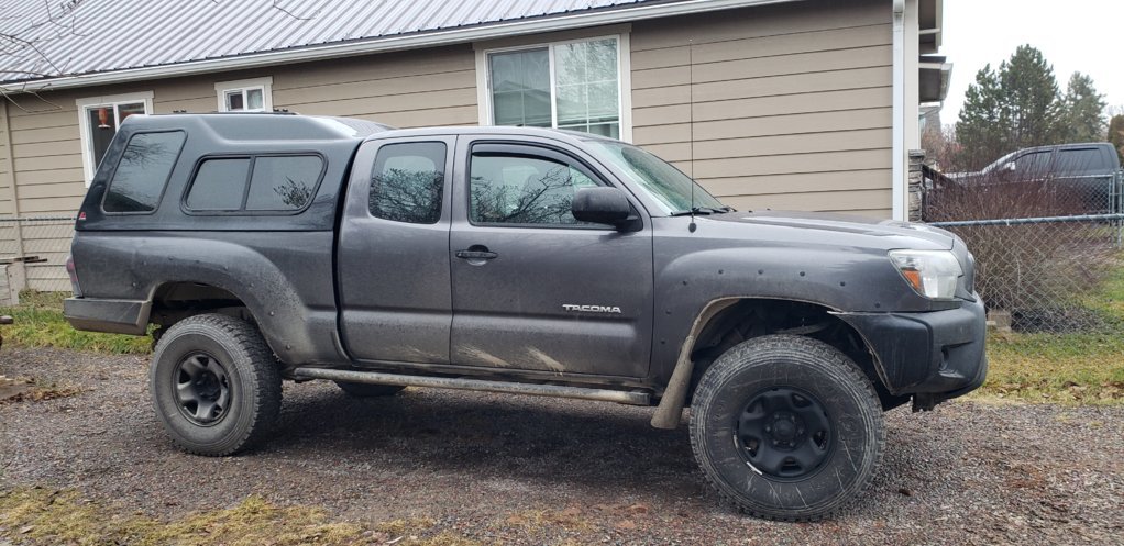

    2012 4.0 manual. Battery light came on last night for the first time in the truck's life. Engine is making a whining noise that most people wouldn't notice. Multimeter shows 14.4ish volts at the battery with the truck running. Alternator was my guess, but multimeter says otherwise. Battery is Northstar AGM 24F, maybe 3 or 4 years old. I keep it maintained pretty regularly - put it on the charger overnight once a month, more when ive been winching a lot.
    Any ideas?
