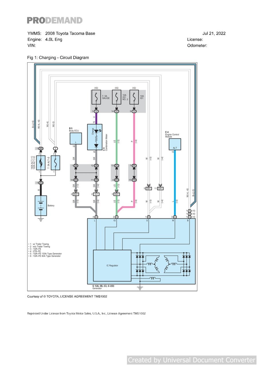

    Battery light is controlled by the alternator, it should only illuminate when there's a problem with the alternator. The only other thing that would turn the light on is if the L wire was shorted to ground.
    It's easy to test the alternator, battery voltage should be 13.2-14.8 with the engine running and all loads (blower on high, headlights on high, etc) on. If it's not first check the ALT-S Fuse (7.5A) in the underhood fuse box, if it's good you need to check for power on the big wire at the alternator as well as pins 1 and 2 of the alternator connector with the key on, if that all checks out but it's not charging then the alternator is bad.
