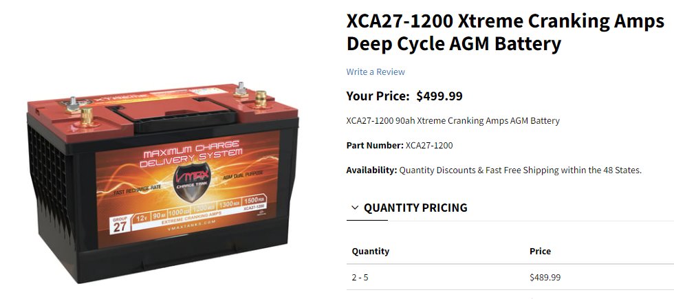

    Maybe this guy? And highly doubtful a stock Taco can charge that fully. Need a voltage booster prolly. But i'm betting it's just the alternator. Specially if it's original.

    that thing looks big and heavy, hopefully doesn’t cause sheet metal to crack or tear

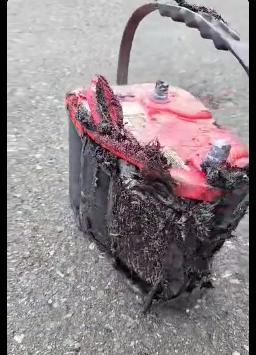

    I'm running a similar battery. like 1 pound less. Hasn't fallen outta my wheel well yet. I joke cause I had a friend with a Ranger recently have his truck yeet the battery onto the street.

    Are you positive that really happened? Your friend can charge you with a negative story about him.:anonymous:

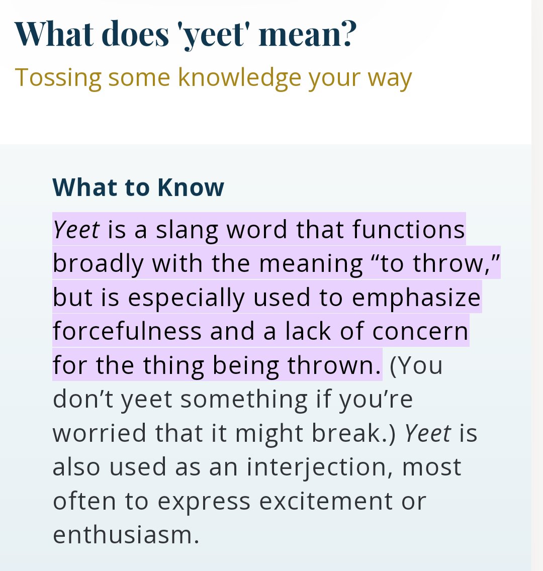

    YEET
    WTF is that?

    Really happened. He was really amped up afterwards. Here's a screen snip from the video he took of the aftermath. His tire ate 1/4 of the battery away. Right to the plates.
