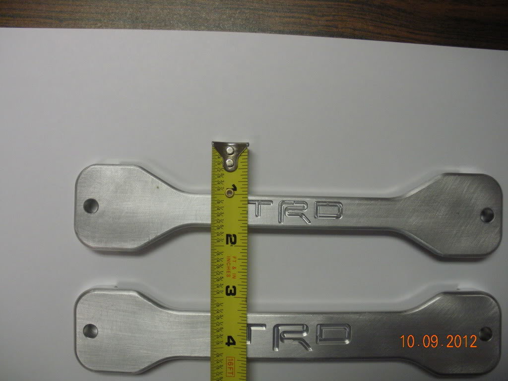

    I also just bought 1 of these.
    To go along with this.
