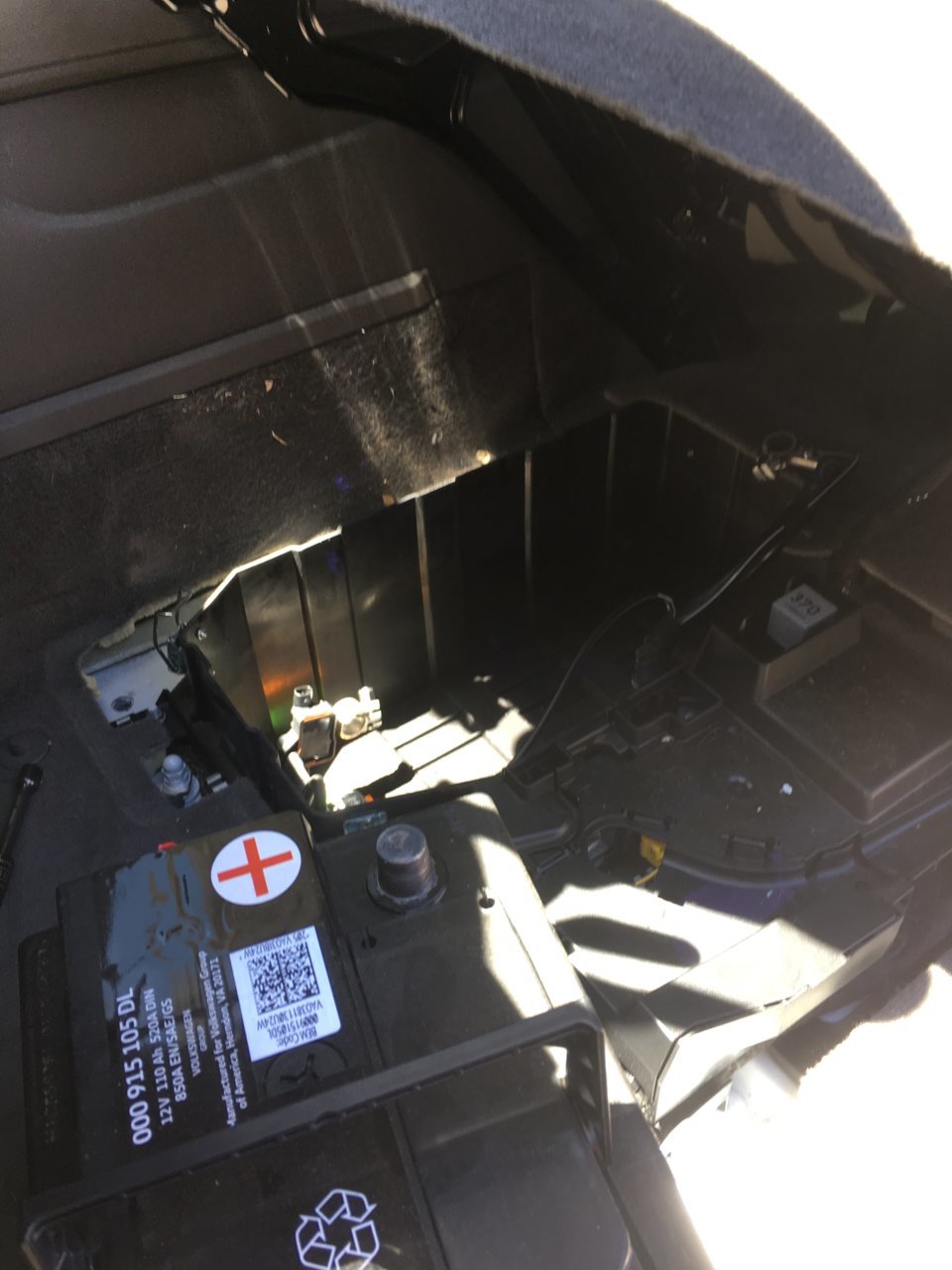

    A few curse words were involved with the r/r of the battery on my wife's vehicle

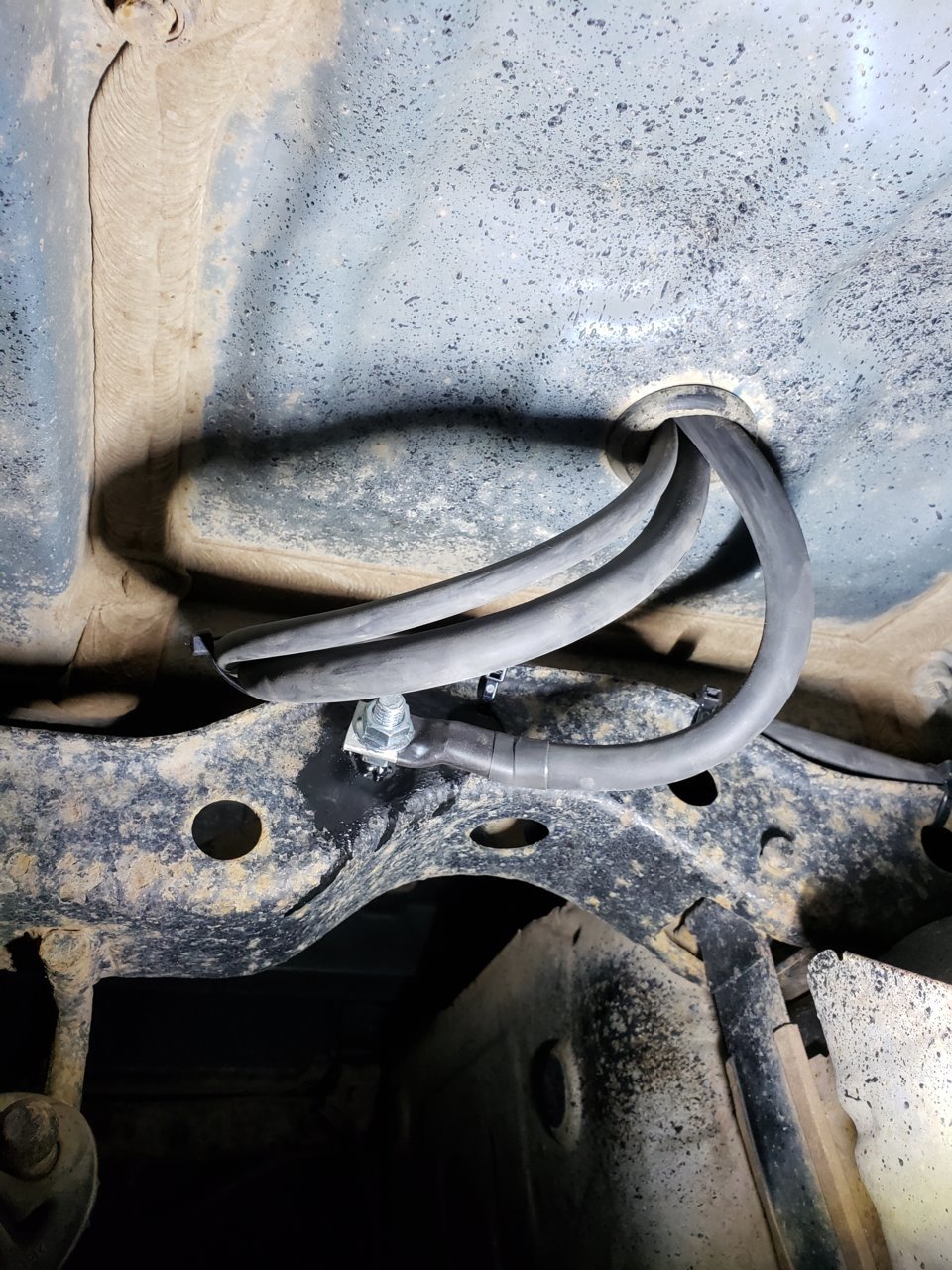

    I’d hate to be there when those cables finish wearing through to the wall
