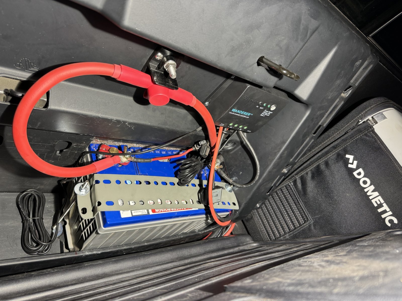

    Was able to fit a group 27F battery in the rear cubby (cut out the plastic floor and back, left the carpet intact).
    Seems fine so far!

    And this relocation moved 60lbs off the front axles to the rear.

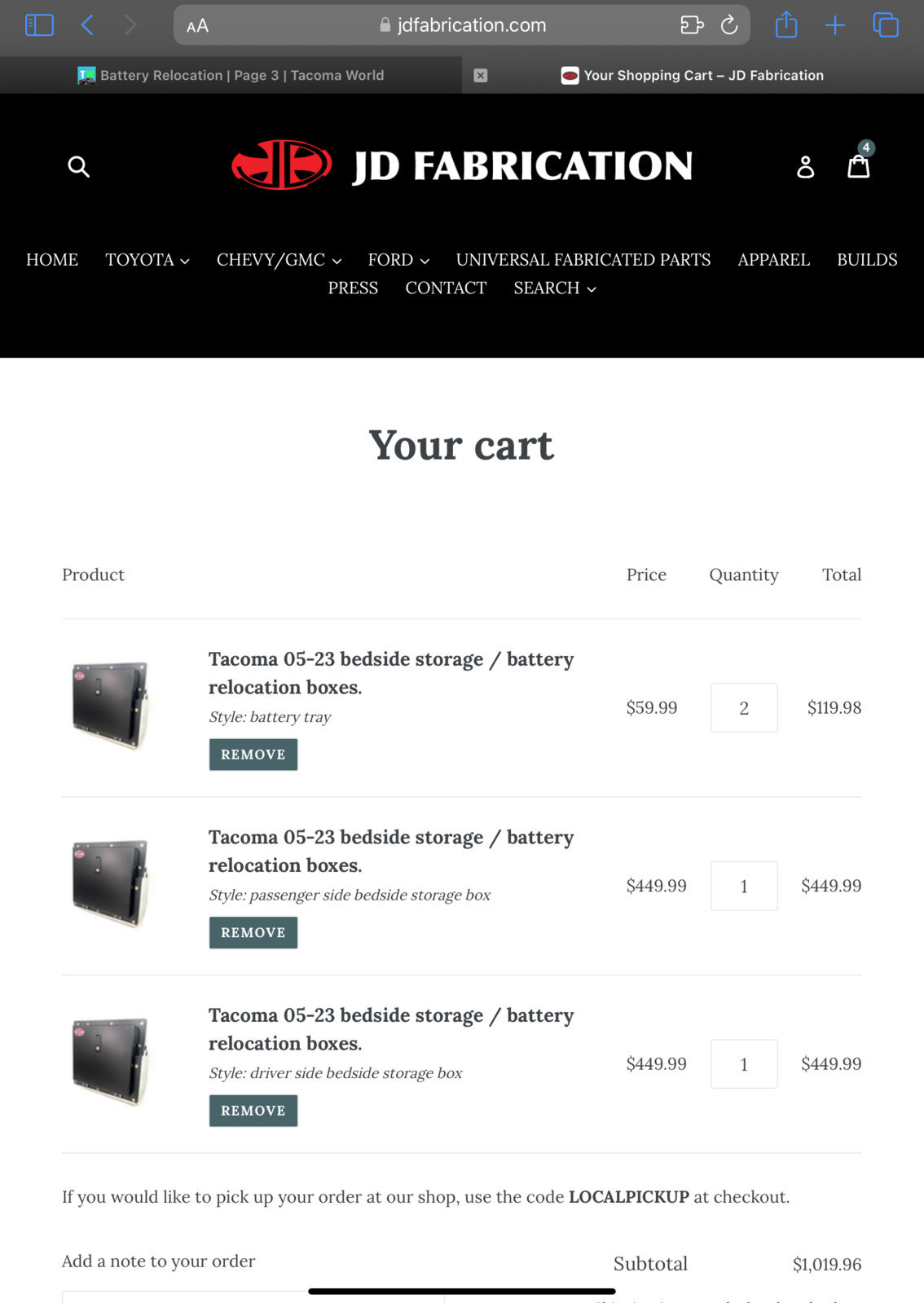

    I've been looking at the JD Fab rear bedside compartment battery relo box. Looks like a good design, a bit on the $$ but that's what it is for US-made low-volume custom parts. It's not like there's a large market for such a product, they might sell only a thousand or two of them over entire product cycle.

    It's about $500 a box -- i.e. per side. Hence my original remark about the exorbitant cost.
    If these were manufactured in China in quantities of ?? maybe 25,000 to 50,000 units they could probably be sold for $160 each, at a guess. But that's just not how it goes. Just how many 2nd & 3rd gen Tacoma owners make up the target market for these bespoke bedside battery boxes? IDK but I'd guess not more than a few thousand, and of that target market -- those of us who would seriously consider it -- maybe only ?? 25% of them will actually buy one.
    At $500 a unit, if they sell 100 units ($50K,) maybe they've broken even on development costs? And then maybe they sell 500-1000 more (ever, i.e. until the 2nd/3rd gen Taco market dwindles down due to attrition), that's a decent chunk of gross receipts.

    At first it was not displaying the product menu correctly, and I thought $450 was reasonable for both based on the plural "boxes" in the title. You also lose the notches to fit 2*. 2x4s. I wonder how long an uglier but safe and functional DIY similar solution would take to do.

    Looking at price of $1100 for both sides has me thinking, strongly: I could put $1100 into a decent plasma cutter setup. I already have a decent MIG welder. With plasma + MIG I might be able to fab up something half-decent in 5 or 6 hours.
