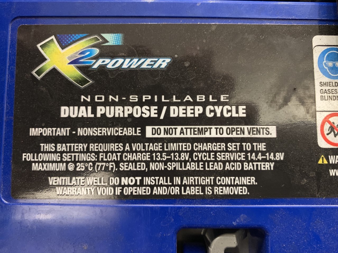

    leid
    leid Well-Known Member
    Jun 24, 2020
    #332423
    449
    Brandon, MS
    1997 V6 Tacoma 4x4 & 2020 V6 Tacoma TRD 4x4
    ECGS & ZUK diffs w lockers/Marlin R150F/NITRO axles/winches
    Northstar even put this info on their X2 Power AGM battery label. A wealth of information on the subject is contained in this linked thread: https://www.tacomaworld.com/threads/the-northstar-agm-battery-voltage-booster-upgrade.604478/
    Key-Rei, Montana_Actual and tacotoe like this.

    Benny
    You guys can quote all the articles you like. Bottom line is 10 minutes after shutdown, my AGM battery reads 12.9~13.1(dependent on temp), and that's fully charged.
    The only thing higher voltage would do, is get it fully charged faster. Totally unnessasary to run higher voltage.
