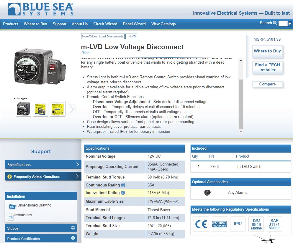

    You could be right, too many variables to account for. This whole conversation has me considering a m-LVD Voltage Disconnect from Blue Sea Systems. It would have saved OP if his accessories were wired through it. I have ditch lights and bumper lights on order and I think this discussion convinced me to wire a low voltage disconnect between my aux fuse block and the battery just in case someone leaves my accessories on.

    Thanks again to TW. I learned alot reading the posts and watching the videos you guys sent my way. And that low voltage cutoff looks interesting. I may use this to tell the wife just how necessary it is!

    Hey man, nice work! One thing: that low voltage disconnect will only work for lower amp draw circuits (lights, stereo, gmrs radio, etc.). Depending on the winch you run and the load you place on it, you could pull up to 400A. Do NOT wire a winch through that disconnect as it is only rated for 65A. Your best bet is to wire a winch disconnect like this FJ cruiser bubba did.
