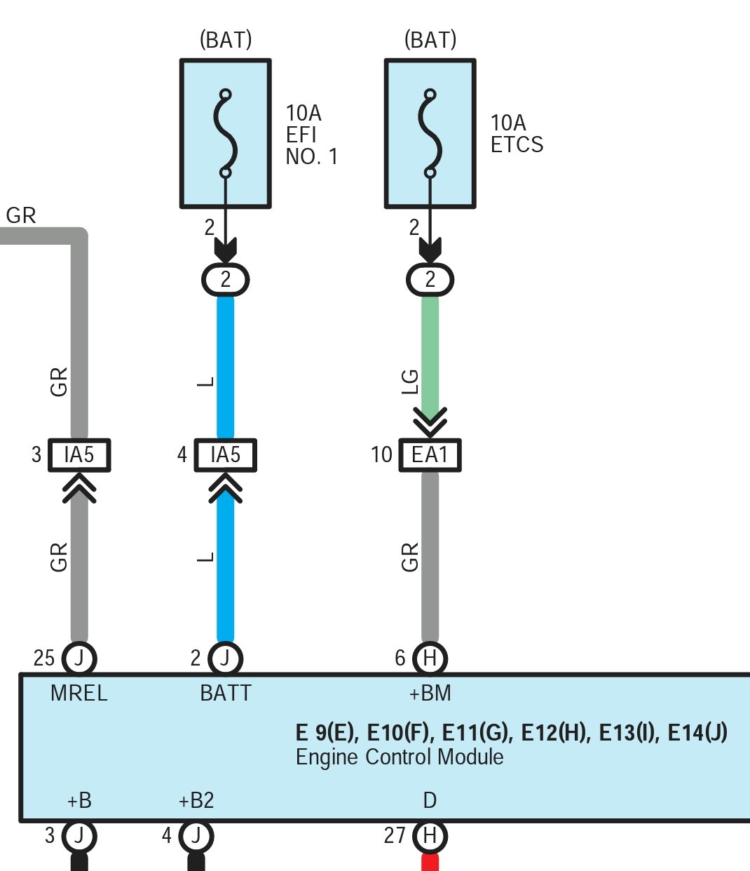

  5. Mar 25, 2023 at 12:55 PM
    #45
    ktbell444
    ktbell444 One who throws exceptions
    Aug 8, 2017
    #226306
    2,969
    ᚺᛖᛚᚺᛖᛁᛗ
    Both of those fuses are on battery power, not ignition, so they are only abnormal because your battery's voltage is low.
