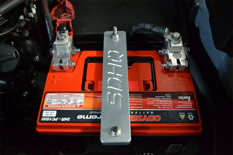

    The OEM battery terminals are cheeseball. Yes, I'm gonna call them terminals. Other people can call them whatever they want. The marine terminals are much more substantial. A chunk of lead with a pinch bolt and a threaded stud. There are other aftermarket terminals that are even better, but you can't buy them at your local auto parts store. The positive is a direct swap. The negative is a little more involved.

    @euroshowoff It’s your truck. You can do whatever you want, but those terminals were barely adequate when they were new and the only electrical draw was the truck. You now have a lot of electrical demand from all your added on equipment and the cheeseball terminals are compromised by the corrosion. These are the terminals I use and they’re NICE.

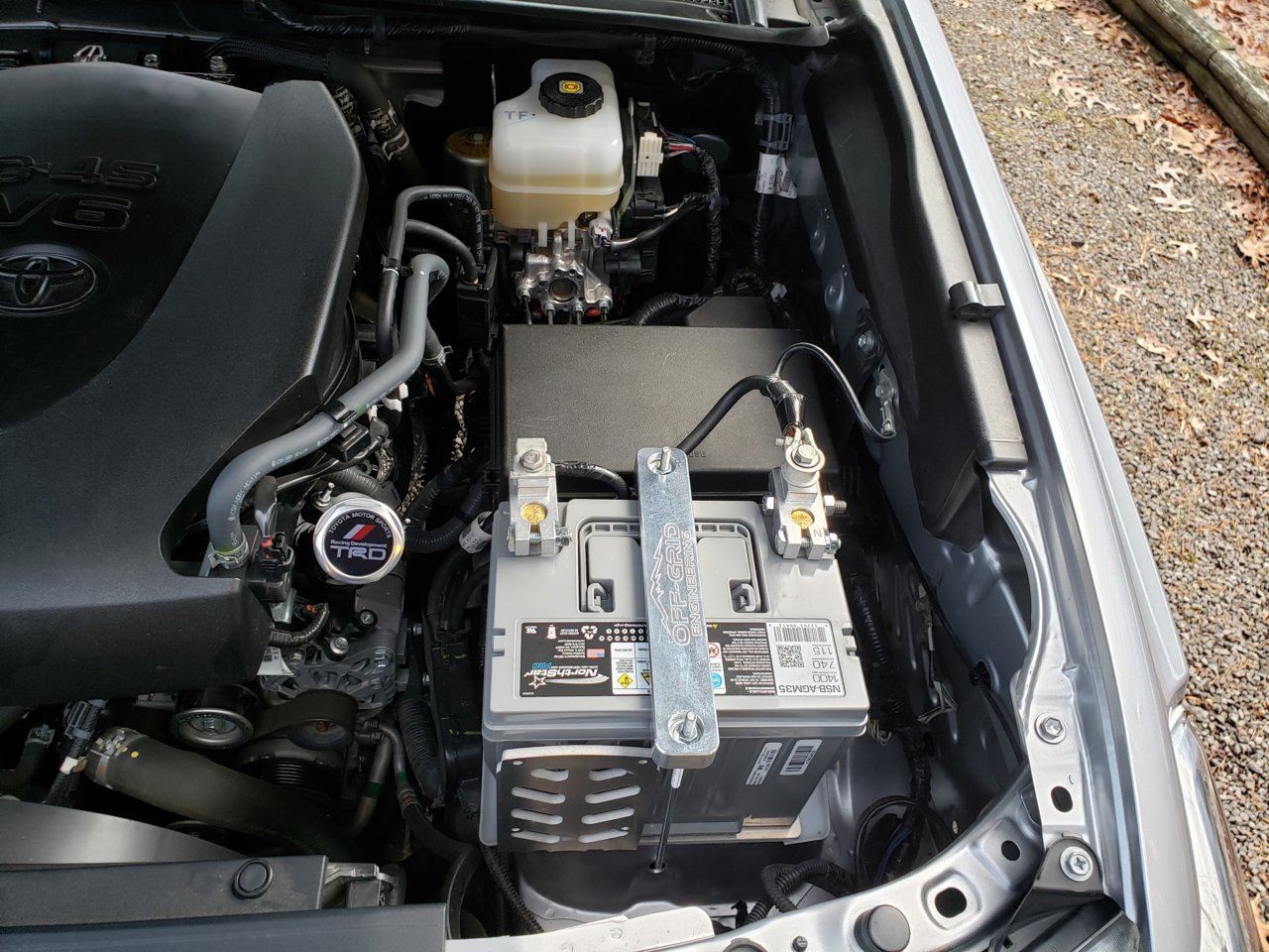

    I did the same, AGM 24F to save weight. If you use dielectric grease be sure to smear that on AFTER making the connections.
