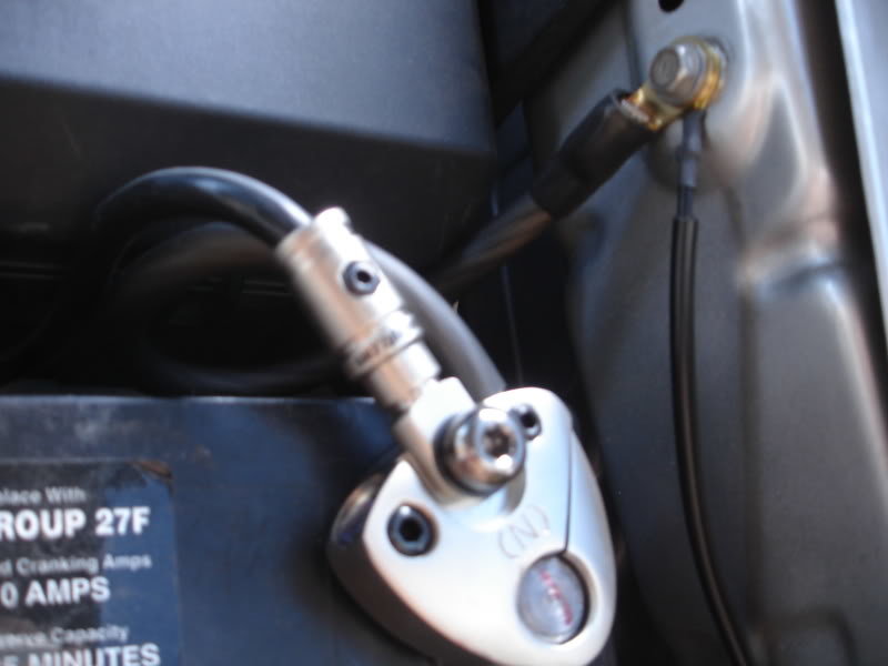

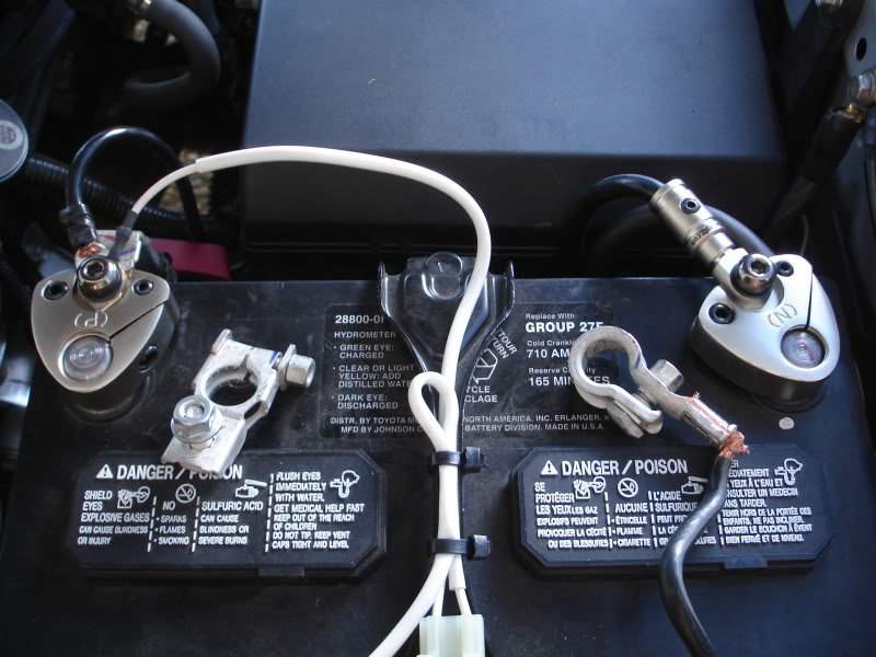

    Is this what you are referring? [​IMG]

    Yes, this is exactly what I'm referring to! It looks like you trimed the square piece to be round to fit the middle post? I believe you have the EXACT set up as mine, even down to the new blue 4 gauge amp wire! Thanks in advance for any clarification.

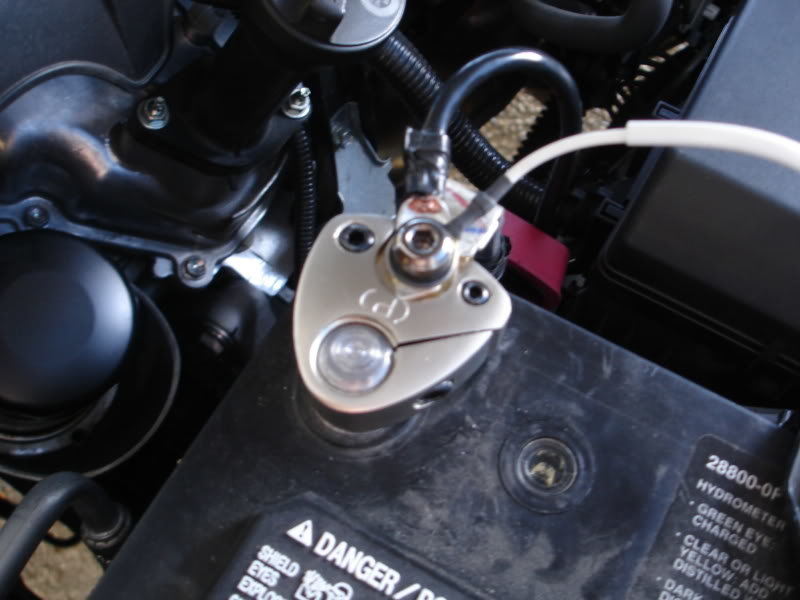

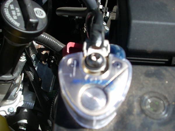

    Well, thanks to Sooner07 and his great reference pics, I decided to do the exact same thing. It took but 2 songs and 3 wheels to cut four sides off of the connection, the first two were the hang down parts on the sides and the other two were to get the angle right at the tip.
    I upgraded the positive and negative posts since I was in there. I also upgraded the ground cable to body, with a good sanding of the ground portion of the chassis, a quick little spin with the sanding wheel got me where I need to be in seconds, damn that dremel is awesome.
    I have not connected the positive 4 gauge cable yet as I haven't hooked up the amp yet, but I am prepared.
    Anyways, I posted pics in case someone in the future has the same question. Big difference between the old and the new!
