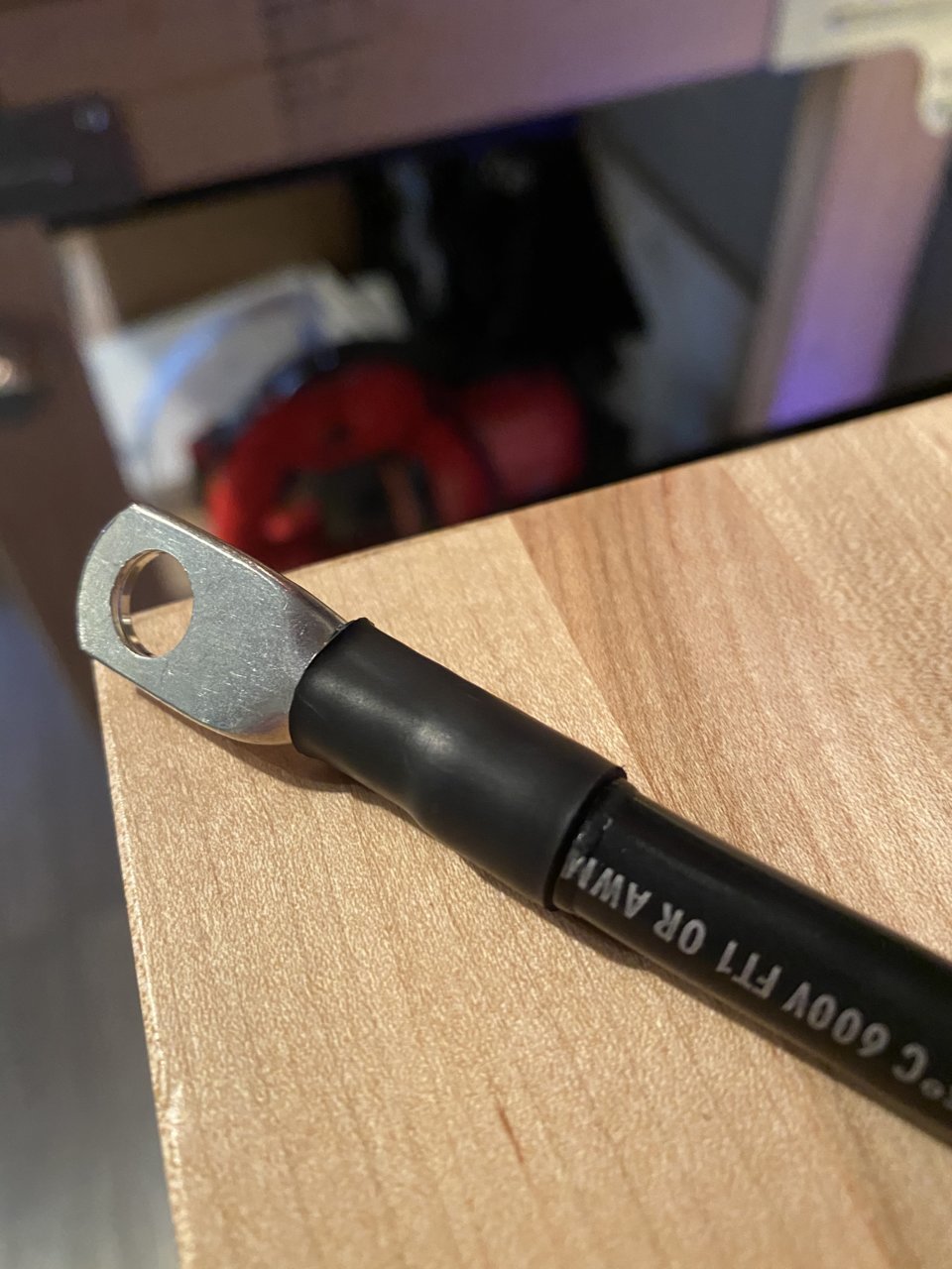

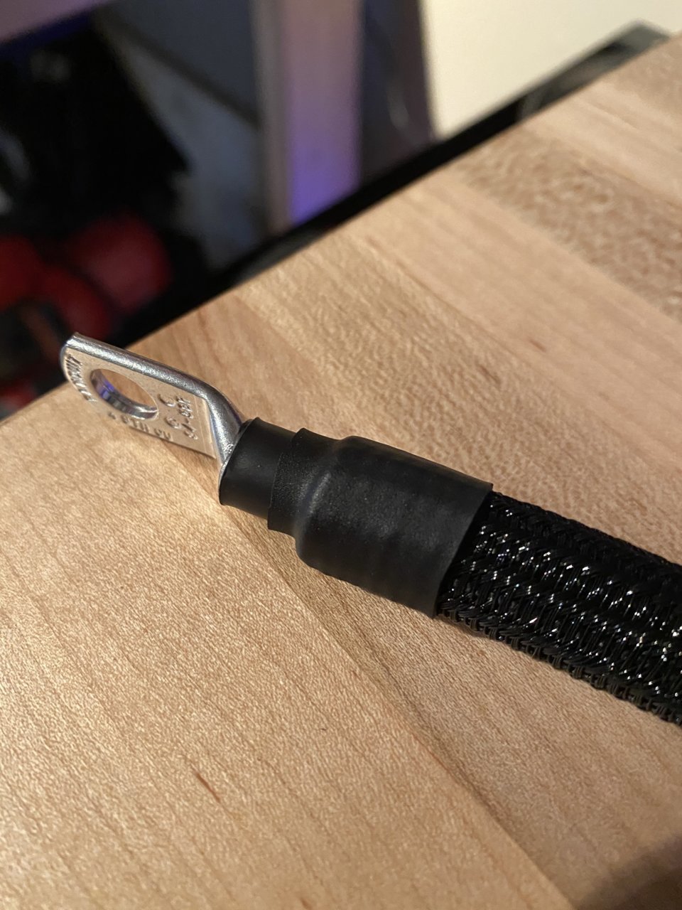

    @prone2xl I know it's several months after your post, but the few potential problems are:
    1. The material of the inner heat shrink has a lower temp rating than the outer heat shrink. The risk here is that burn the inner heat shrink while shrinking the outer. Burned material introduces carbon which is conductive rendering the inner heat shrink ineffective.
    2. The inner heat shrink is epoxy lined and the epoxy reflows when heating up the outer heat shrink. That would in turn allow the inner heat shrink to move. This is less about performance problems and more about visual/workmanship problems. But your sample looks pretty good.
