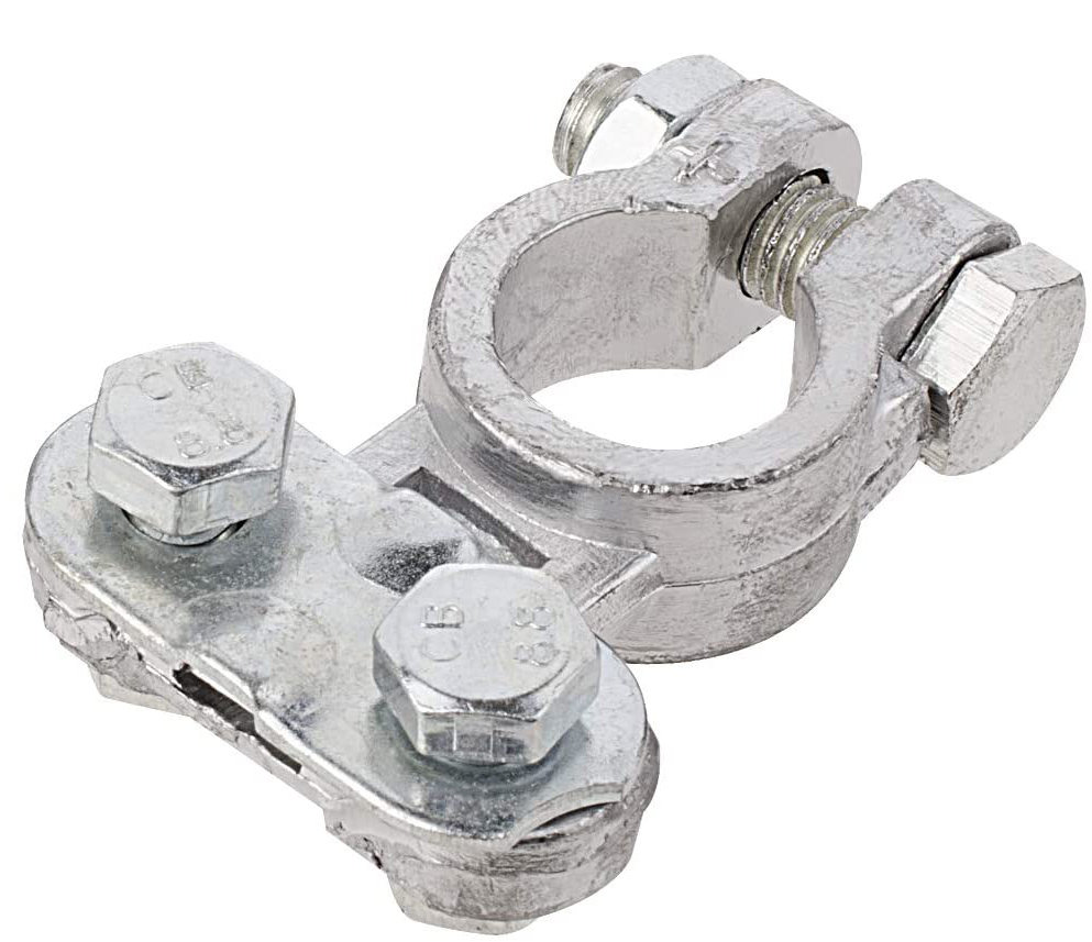

    If you have an auto electric shop around they will have everything you need. My local shop has built me many replacement cables for different equipment over the years for a reasonable price.
    The crappy type below will get you home in an emergency but are poorly made junk, don't even bother with them.
